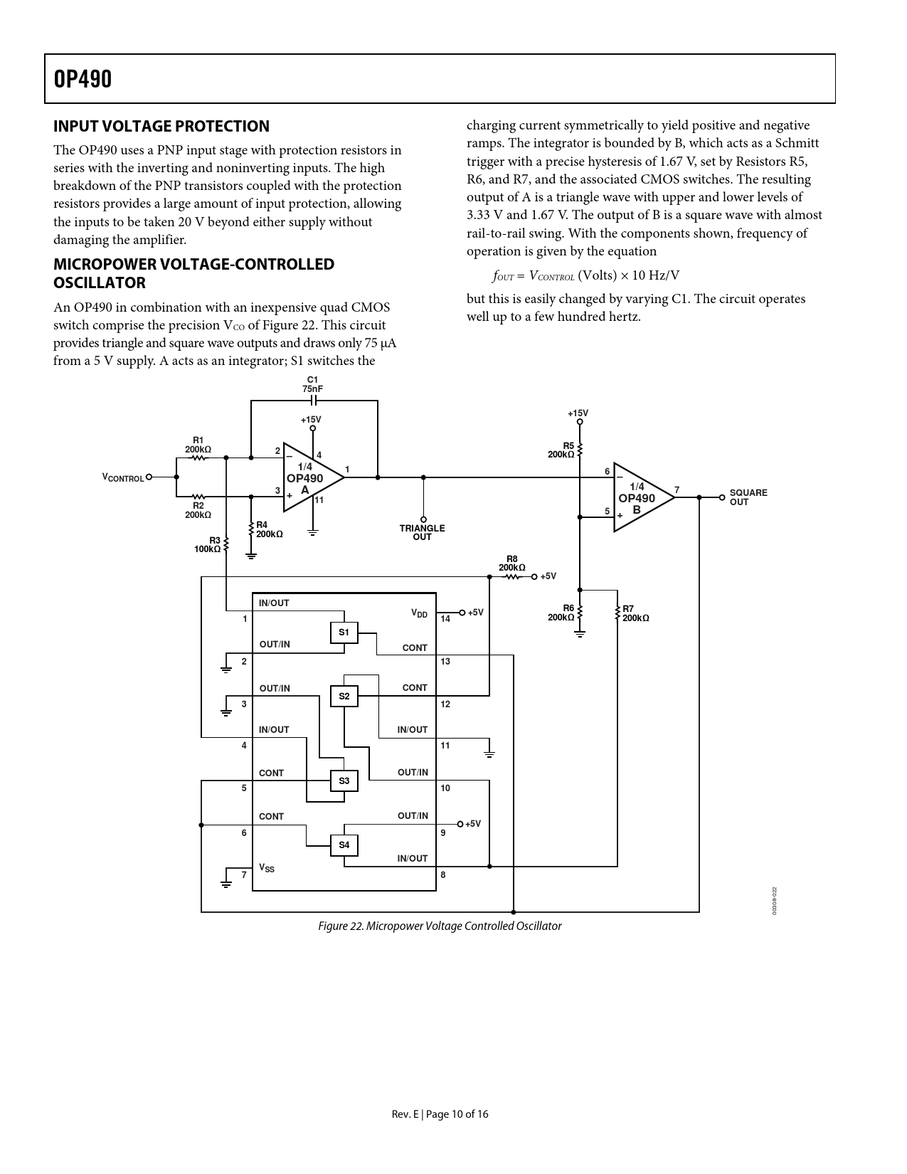

OP490. INPUT VOLTAGE PROTECTION. MICROPOWER VOLTAGE-CONTROLLED. OSCILLATOR. 75nF. +15V. 200kΩ. 2 –. 1/4. 6 –. VCONTROL. 3 + A. SQUARE OUT. 5 +
OP490 INPUT VOLTAGE PROTECTION MICROPOWER VOLTAGE-CONTROLLED OSCILLATOR 75nF +15V 200kΩ 2 – 1/4 6 – VCONTROL 3 + A SQUARE OUT 5 +
link to page 10
charging current symmetrically to yield positive and negative The OP490 uses a PNP input stage with protection resistors in ramps. The integrator is bounded by B, which acts as a Schmitt series with the inverting and noninverting inputs. The high trigger with a precise hysteresis of 1.67 V, set by Resistors R5, breakdown of the PNP transistors coupled with the protection R6, and R7, and the associated CMOS switches. The resulting resistors provides a large amount of input protection, allowing output of A is a triangle wave with upper and lower levels of the inputs to be taken 20 V beyond either supply without 3.33 V and 1.67 V. The output of B is a square wave with almost damaging the amplifier. rail-to-rail swing. With the components shown, frequency of operation is given by the equation
f
OSCILLATOR
OUT = VCONTROL (Volts) × 10 Hz/V but this is easily changed by varying C1. The circuit operates An OP490 in combination with an inexpensive quad CMOS well up to a few hundred hertz. switch comprise the precision VCO of Figure 22. This circuit provides triangle and square wave outputs and draws only 75 μA from a 5 V supply. A acts as an integrator; S1 switches the
C1 75nF +15V +15V R1 200kΩ 2 – R5 4 200kΩ 1/4 1 6 – VCONTROL OP490 3 + A 1/4 7 11 OP490 SQUARE OUT R2 5 + B 200kΩ R4 TRIANGLE 200kΩ OUT R3 100kΩ R8 200kΩ +5V IN/OUT V R6 R7 DD +5V 1 14 200kΩ 200kΩ S1 OUT/IN CONT 2 13 OUT/IN CONT S2 3 12 IN/OUT IN/OUT 4 11 CONT OUT/IN S3 5 10 CONT OUT/IN +5V 6 9 S4 IN/OUT VSS 7 8
