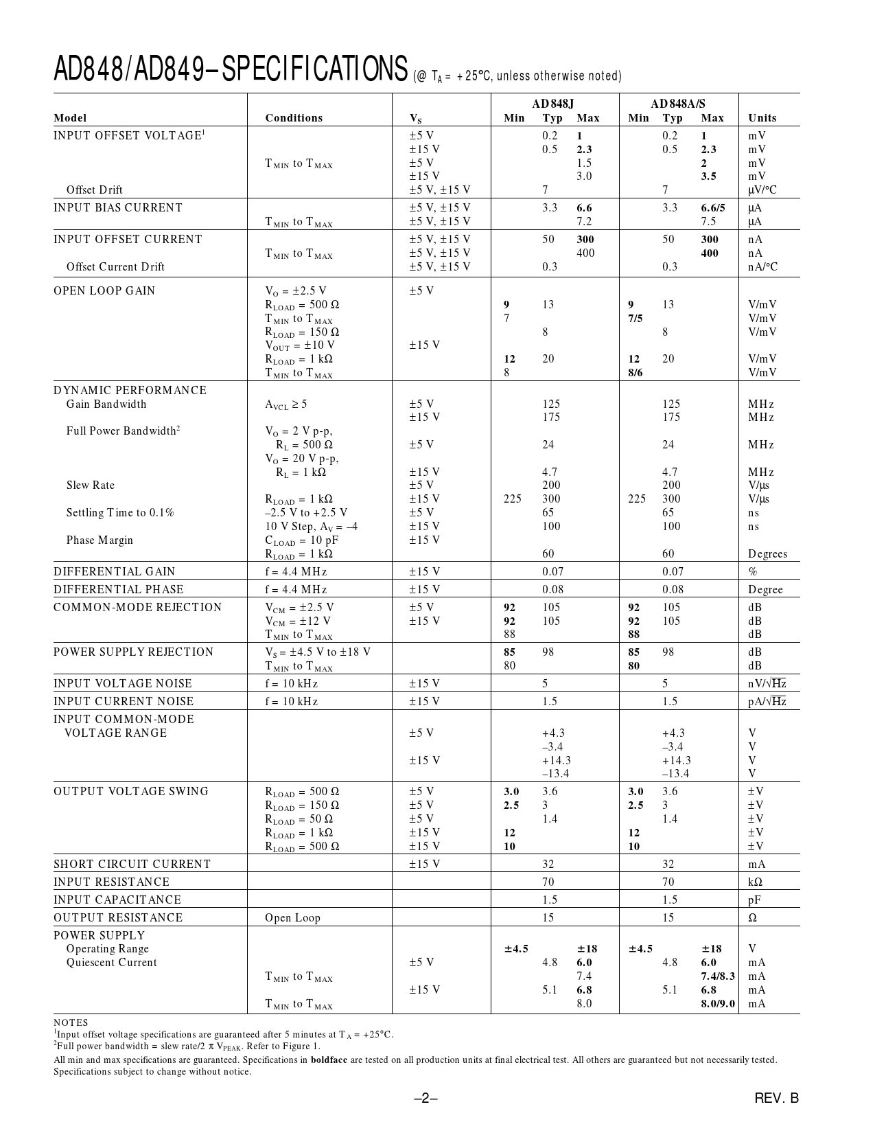

AD848/AD849–SPECIFICATIONS (@ TA = +25. C, unless otherwise noted). AD848J. AD848A/S. Model. Conditions. Min. Typ. Max. Units. 2.3. 3.5. 6.6
AD848/AD849–SPECIFICATIONS (@ TA = +25 C, unless otherwise noted) AD848J AD848A/S Model Conditions Min Typ Max Units 2.3 3.5 6.6
8
C, unless otherwise noted) AD848J AD848A/S Model Conditions VS Min Typ Max Min Typ Max Units
INPUT OFFSET VOLTAGE1 ±5 V 0.2
1
0.2
1
mV ±15 V 0.5
2.3
0.5
2.3
mV T ± MIN to TMAX 5 V 1.5
2
mV ±15 V 3.0
3.5
mV Offset Drift ±5 V, ±15 V 7 7 µV/°C INPUT BIAS CURRENT ±5 V, ±15 V 3.3
6.6
3.3
6.6/5
µA T ± MIN to TMAX 5 V, ± 15 V 7.2 7.5 µA INPUT OFFSET CURRENT ±5 V, ±15 V 50
300
50
300
nA T ± MIN to TMAX 5 V, ± 15 V 400
400
nA Offset Current Drift ±5 V, ±15 V 0.3 0.3 nA/°C OPEN LOOP GAIN VO = ± 2.5 V ±5 V RLOAD = 500 Ω
9
13
9
13 V/mV TMIN to TMAX 7
7/5
V/mV RLOAD = 150 Ω 8 8 V/mV VOUT = ± 10 V ±15 V RLOAD = 1 kΩ
12
20
12
20 V/mV TMIN to TMAX 8
8/6
V/mV DYNAMIC PERFORMANCE Gain Bandwidth AVCL ≥ 5 ±5 V 125 125 MHz ±15 V 175 175 MHz Full Power Bandwidth2 VO = 2 V p-p, RL = 500 Ω ±5 V 24 24 MHz VO = 20 V p-p, RL = 1 kΩ ±15 V 4.7 4.7 MHz Slew Rate ±5 V 200 200 V/µs RLOAD = 1 kΩ ±15 V 225 300 225 300 V/µs Settling Time to 0.1% –2.5 V to +2.5 V ±5 V 65 65 ns 10 V Step, AV = –4 ±15 V 100 100 ns Phase Margin CLOAD = 10 pF ±15 V RLOAD = 1 kΩ 60 60 Degrees DIFFERENTIAL GAIN f = 4.4 MHz ±15 V 0.07 0.07 % DIFFERENTIAL PHASE f = 4.4 MHz ±15 V 0.08 0.08 Degree COMMON-MODE REJECTION VCM = ± 2.5 V ±5 V
92
105
92
105 dB VCM = ± 12 V ±15 V
92
105
92
105 dB TMIN to TMAX 88
88
dB POWER SUPPLY REJECTION VS = ± 4.5 V to ± 18 V
85
98
85
98 dB TMIN to TMAX 80
80
dB INPUT VOLTAGE NOISE f = 10 kHz ±15 V 5 5 nV/√Hz INPUT CURRENT NOISE f = 10 kHz ±15 V 1.5 1.5 pA/√Hz INPUT COMMON-MODE VOLTAGE RANGE ±5 V +4.3 +4.3 V –3.4 –3.4 V ±15 V +14.3 +14.3 V –13.4 –13.4 V OUTPUT VOLTAGE SWING RLOAD = 500 Ω ±5 V
3.0
3.6
3.0
3.6 ±V RLOAD = 150 Ω ±5 V
2.5
3
2.5
3 ±V RLOAD = 50 Ω ±5 V 1.4 1.4 ±V RLOAD = 1 kΩ ±15 V
12 12
±V RLOAD = 500 Ω ±15 V
10 10
±V SHORT CIRCUIT CURRENT ±15 V 32 32 mA INPUT RESISTANCE 70 70 kΩ INPUT CAPACITANCE 1.5 1.5 pF OUTPUT RESISTANCE Open Loop 15 15 Ω POWER SUPPLY Operating Range 6
4.5
6
18
6
4.5
6
18
V Quiescent Current ±5 V 4.8
6.0
4.8
6.0
mA TMIN to TMAX 7.4
7.4/8.3
mA ±15 V 5.1
6.8
5.1
6.8
mA TMIN to TMAX 8.0
8.0/9.0
mA NOTES 1Input offset voltage specifications are guaranteed after 5 minutes at TA = +25°C. 2Full power bandwidth = slew rate/2 π VPEAK. Refer to Figure 1. All min and max specifications are guaranteed. Specifications in
