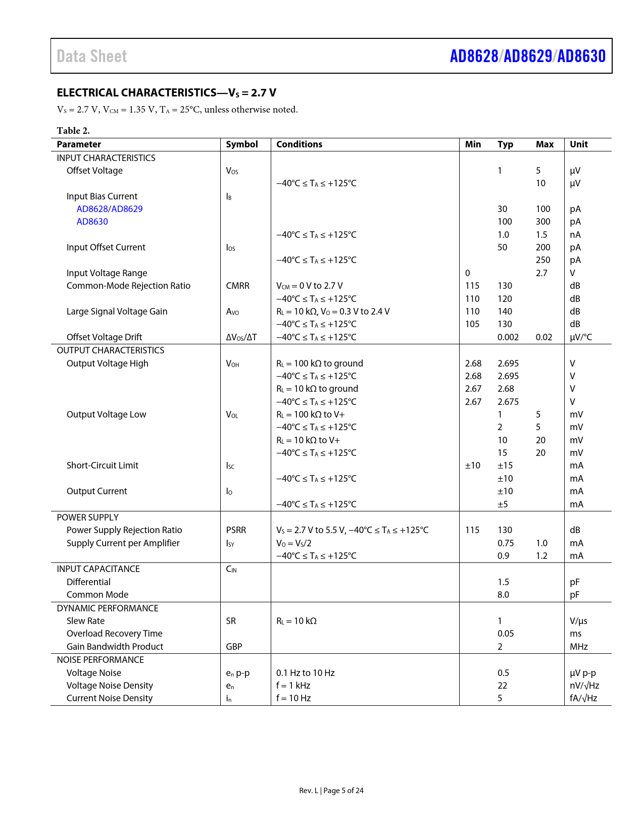

Data Sheet. AD8628/. AD8629/. AD8630. ELECTRICAL CHARACTERISTICS—VS = 2.7 V. Table 2. Parameter Symbol. Conditions. Min. Typ. Max. Unit
Data Sheet AD8628/ AD8629/ AD8630 ELECTRICAL CHARACTERISTICS—VS = 2.7 V Table 2 Parameter Symbol Conditions Min Typ Max Unit
VS = 2.7 V, VCM = 1.35 V, TA = 25°C, unless otherwise noted.
Table 2. Parameter Symbol Conditions Min Typ Max Unit
INPUT CHARACTERISTICS Offset Voltage VOS 1 5 μV −40°C ≤ TA ≤ +125°C 10 μV Input Bias Current IB AD8628/AD8629 30 100 pA AD8630 100 300 pA −40°C ≤ TA ≤ +125°C 1.0 1.5 nA Input Offset Current IOS 50 200 pA −40°C ≤ TA ≤ +125°C 250 pA Input Voltage Range 0 2.7 V Common-Mode Rejection Ratio CMRR VCM = 0 V to 2.7 V 115 130 dB −40°C ≤ TA ≤ +125°C 110 120 dB Large Signal Voltage Gain AVO RL = 10 kΩ, VO = 0.3 V to 2.4 V 110 140 dB −40°C ≤ TA ≤ +125°C 105 130 dB Offset Voltage Drift ∆VOS/∆T −40°C ≤ TA ≤ +125°C 0.002 0.02 μV/°C OUTPUT CHARACTERISTICS Output Voltage High VOH RL = 100 kΩ to ground 2.68 2.695 V −40°C ≤ TA ≤ +125°C 2.68 2.695 V RL = 10 kΩ to ground 2.67 2.68 V −40°C ≤ TA ≤ +125°C 2.67 2.675 V Output Voltage Low VOL RL = 100 kΩ to V+ 1 5 mV −40°C ≤ TA ≤ +125°C 2 5 mV RL = 10 kΩ to V+ 10 20 mV −40°C ≤ TA ≤ +125°C 15 20 mV Short-Circuit Limit ISC ±10 ±15 mA −40°C ≤ TA ≤ +125°C ±10 mA Output Current IO ±10 mA −40°C ≤ TA ≤ +125°C ±5 mA POWER SUPPLY Power Supply Rejection Ratio PSRR VS = 2.7 V to 5.5 V, −40°C ≤ TA ≤ +125°C 115 130 dB Supply Current per Amplifier ISY VO = VS/2 0.75 1.0 mA −40°C ≤ TA ≤ +125°C 0.9 1.2 mA INPUT CAPACITANCE CIN Differential 1.5 pF Common Mode 8.0 pF DYNAMIC PERFORMANCE Slew Rate SR RL = 10 kΩ 1 V/μs Overload Recovery Time 0.05 ms Gain Bandwidth Product GBP 2 MHz NOISE PERFORMANCE Voltage Noise en p-p 0.1 Hz to 10 Hz 0.5 μV p-p Voltage Noise Density en f = 1 kHz 22 nV/√Hz Current Noise Density in f = 10 Hz 5 fA/√Hz Rev. L | Page 5 of 24 Document Outline FEATURES APPLICATIONS GENERAL DESCRIPTION PIN CONFIGURATIONS TABLE OF CONTENTS REVISION HISTORY SPECIFICATIONS ELECTRICAL CHARACTERISTICS—VS = 5.0 V ELECTRICAL CHARACTERISTICS—VS = 2.7 V ABSOLUTE MAXIMUM RATINGS THERMAL CHARACTERISTICS ESD CAUTION TYPICAL PERFORMANCE CHARACTERISTICS FUNCTIONAL DESCRIPTION 1/f NOISE PEAK-TO-PEAK NOISE NOISE BEHAVIOR WITH FIRST-ORDER, LOW-PASS FILTER TOTAL INTEGRATED INPUT-REFERRED NOISE FOR FIRST-ORDER FILTER INPUT OVERVOLTAGE PROTECTION OUTPUT PHASE REVERSAL OVERLOAD RECOVERY TIME INFRARED SENSORS PRECISION CURRENT SHUNT SENSOR OUTPUT AMPLIFIER FOR HIGH PRECISION DACS OUTLINE DIMENSIONS ORDERING GUIDE AUTOMOTIVE PRODUCTS
