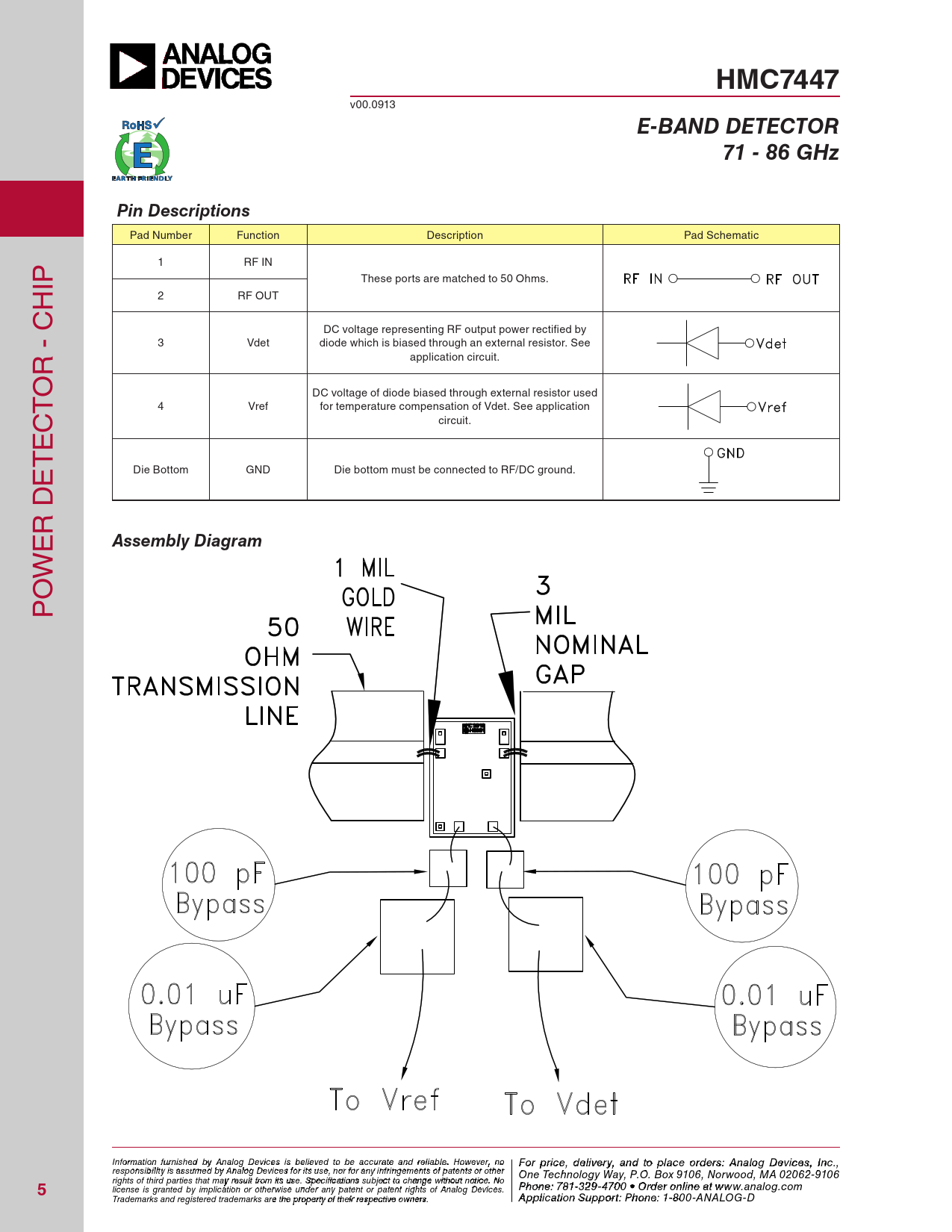

E-BAND DETECTOR 71 - 86 GHz Pin Descriptions
Pad Number Function Description Pad Schematic 1 RF IN IP These ports are matched to 50 Ohms. H 2 RF OUT DC voltage representing RF output power rectified by 3 Vdet diode which is biased through an external resistor. See R - C application circuit. O T DC voltage of diode biased through external resistor used 4 Vref for temperature compensation of Vdet. See application C circuit. E T E Die Bottom GND Die bottom must be connected to RF/DC ground. R D E
Assembly Diagram
