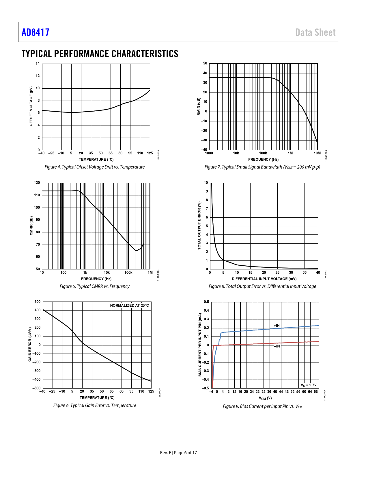

AD8417. Data Sheet. TYPICAL PERFORMANCE CHARACTERISTICS. E (µ G A. LT O. N ( AI. T V. –10. OFFS. –20. –30. –40. –25. 110. 125. 1000. 10k. 100k. 10M
AD8417 Data Sheet TYPICAL PERFORMANCE CHARACTERISTICS E (µ G A LT O N ( AI T V –10 OFFS –20 –30 –40 –25 110 125 1000 10k 100k 10M
AD8417 Data Sheet TYPICAL PERFORMANCE CHARACTERISTICS 14 50 40 12 30 V) 10 20 E (µ G A 8 B) 10 d LT O N ( AI T V 6 0 G E –10 OFFS 4 –20 2 –30 0 –40 –40 –25 –10 5 20 35 50 65 80 95 110 125

1 Figure 4. Typical Offset Voltage Drift vs. Temperature Figure 7. Typical Small Signal Bandwidth (VOUT = 200 mV p-p)

1 Figure 5. Typical CMRR vs. Frequency Figure 8. Total Output Error vs. Differential Input Voltage

1882- 1 Figure 6. Typical Gain Error vs. Temperature Figure 9. Bias Current per Input Pin vs. VCM Rev. E | Page 6 of 17 Document Outline FEATURES APPLICATIONS GENERAL DESCRIPTION TYPICAL APPLICATION CIRCUIT REVISION HISTORY SPECIFICATIONS ABSOLUTE MAXIMUM RATINGS ESD CAUTION PIN CONFIGURATIONS AND FUNCTION DESCRIPTIONS TYPICAL PERFORMANCE CHARACTERISTICS THEORY OF OPERATION OUTPUT OFFSET ADJUSTMENT UNIDIRECTIONAL OPERATION Ground Referenced Output Mode VS Referenced Output Mode BIDIRECTIONAL OPERATION EXTERNAL REFERENCED OUTPUT SPLITTING THE SUPPLY SPLITTING AN EXTERNAL REFERENCE APPLICATIONS INFORMATION MOTOR CONTROL 3-Phase Motor Control H-Bridge Motor Control SOLENOID CONTROL High-Side Current Sense with a Low-Side Switch High-Side Current Sense with a High-Side Switch High Rail Current Sensing PINOUT OPTION ENGINEERED FOR FMEA OUTLINE DIMENSIONS ORDERING GUIDE AUTOMOTIVE PRODUCTS
