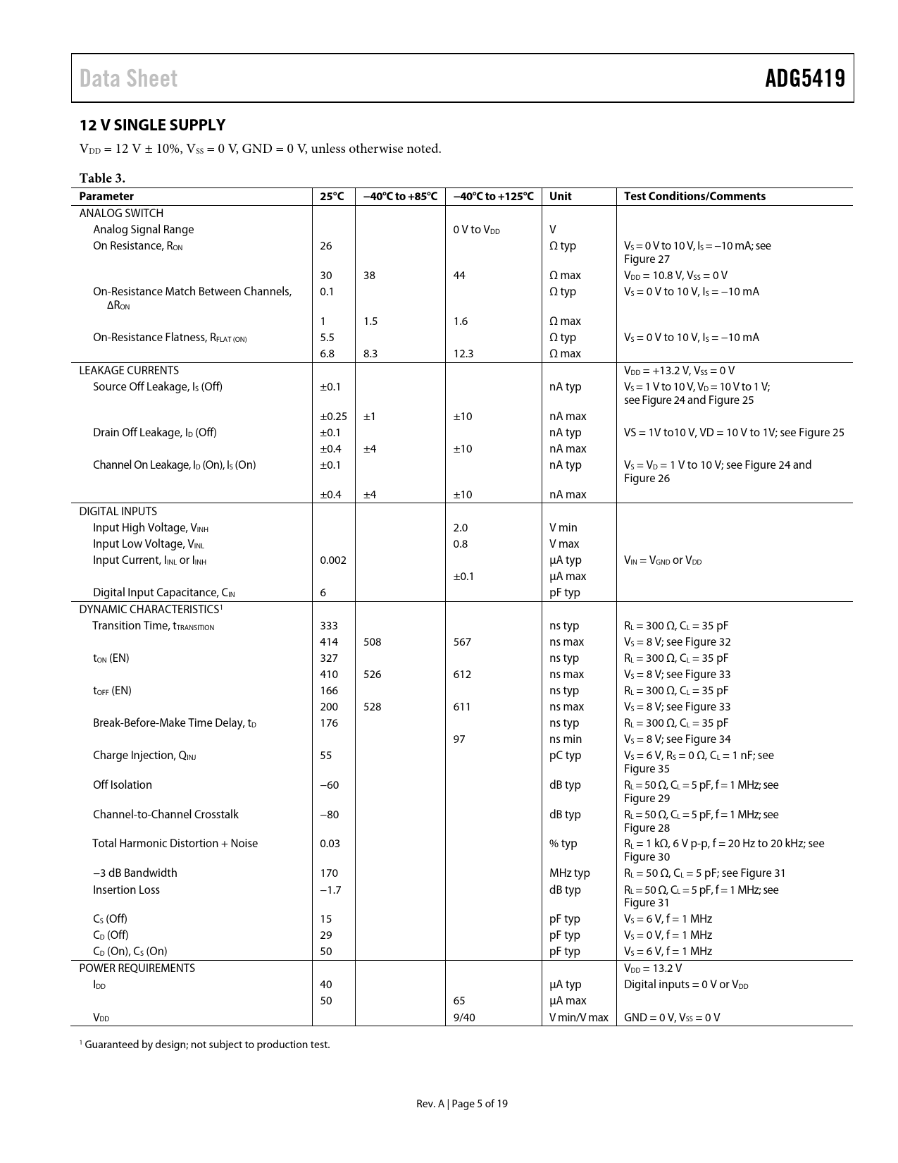

Data Sheet. ADG5419. 12 V SINGLE SUPPLY. Table 3. Parameter. 25°C. −40°C to +85°C. −40°C to +125°C. Unit. Test Conditions/Comments
Data Sheet ADG5419 12 V SINGLE SUPPLY Table 3 Parameter 25°C −40°C to +85°C −40°C to +125°C Unit Test Conditions/Comments
link to page 14 link to page 14 link to page 14 link to page 14 link to page 14 link to page 14 link to page 15 link to page 15 link to page 15 link to page 16 link to page 16 link to page 14 link to page 14 link to page 15 link to page 15 link to page 15
VDD = 12 V ± 10%, VSS = 0 V, GND = 0 V, unless otherwise noted.
Table 3. Parameter 25°C −40°C to +85°C −40°C to +125°C Unit Test Conditions/Comments
ANALOG SWITCH Analog Signal Range 0 V to VDD V On Resistance, RON 26 Ω typ VS = 0 V to 10 V, IS = −10 mA; see Figure 27 30 38 44 Ω max VDD = 10.8 V, VSS = 0 V On-Resistance Match Between Channels, 0.1 Ω typ VS = 0 V to 10 V, IS = −10 mA ∆RON 1 1.5 1.6 Ω max On-Resistance Flatness, RFLAT (ON) 5.5 Ω typ VS = 0 V to 10 V, IS = −10 mA 6.8 8.3 12.3 Ω max LEAKAGE CURRENTS VDD = +13.2 V, VSS = 0 V Source Off Leakage, IS (Off) ±0.1 nA typ VS = 1 V to 10 V, VD = 10 V to 1 V; see Figure 24 and Figure 25 ±0.25 ±1 ±10 nA max Drain Off Leakage, ID (Off) ±0.1 nA typ VS = 1V to10 V, VD = 10 V to 1V; see Figure 25 ±0.4 ±4 ±10 nA max Channel On Leakage, ID (On), IS (On) ±0.1 nA typ VS = VD = 1 V to 10 V; see Figure 24 and Figure 26 ±0.4 ±4 ±10 nA max DIGITAL INPUTS Input High Voltage, VINH 2.0 V min Input Low Voltage, VINL 0.8 V max Input Current, IINL or IINH 0.002 μA typ VIN = VGND or VDD ±0.1 μA max Digital Input Capacitance, CIN 6 pF typ DYNAMIC CHARACTERISTICS1 Transition Time, tTRANSITION 333 ns typ RL = 300 Ω, CL = 35 pF 414 508 567 ns max VS = 8 V; see Figure 32 tON (EN) 327 ns typ RL = 300 Ω, CL = 35 pF 410 526 612 ns max VS = 8 V; see Figure 33 tOFF (EN) 166 ns typ RL = 300 Ω, CL = 35 pF 200 528 611 ns max VS = 8 V; see Figure 33 Break-Before-Make Time Delay, tD 176 ns typ RL = 300 Ω, CL = 35 pF 97 ns min VS = 8 V; see Figure 34 Charge Injection, QINJ 55 pC typ VS = 6 V, RS = 0 Ω, CL = 1 nF; see Figure 35 Off Isolation −60 dB typ RL = 50 Ω, CL = 5 pF, f = 1 MHz; see Figure 29 Channel-to-Channel Crosstalk −80 dB typ RL = 50 Ω, CL = 5 pF, f = 1 MHz; see Figure 28 Total Harmonic Distortion + Noise 0.03 % typ RL = 1 kΩ, 6 V p-p, f = 20 Hz to 20 kHz; see Figure 30 −3 dB Bandwidth 170 MHz typ RL = 50 Ω, CL = 5 pF; see Figure 31 Insertion Loss −1.7 dB typ RL = 50 Ω, CL = 5 pF, f = 1 MHz; see Figure 31 CS (Off) 15 pF typ VS = 6 V, f = 1 MHz CD (Off) 29 pF typ VS = 0 V, f = 1 MHz CD (On), CS (On) 50 pF typ VS = 6 V, f = 1 MHz POWER REQUIREMENTS VDD = 13.2 V IDD 40 μA typ Digital inputs = 0 V or VDD 50 65 μA max VDD 9/40 V min/V max GND = 0 V, VSS = 0 V 1 Guaranteed by design; not subject to production test. Rev. A | Page 5 of 19 Document Outline FEATURES APPLICATIONS FUNCTIONAL BLOCK DIAGRAMS GENERAL DESCRIPTION PRODUCT HIGHLIGHTS TABLE OF CONTENTS REVISION HISTORY SPECIFICATIONS ±15 V DUAL SUPPLY ±20 V DUAL SUPPLY 12 V SINGLE SUPPLY 36 V SINGLE SUPPLY CONTINUOUS CURRENT PER CHANNEL, Sx OR D ABSOLUTE MAXIMUM RATINGS ESD CAUTION PIN CONFIGURATIONS AND FUNCTION DESCRIPTIONS TYPICAL PERFORMANCE CHARACTERISTICS TEST CIRCUITS TERMINOLOGY APPLICATIONS INFORMATION TRENCH ISOLATION OUTLINE DIMENSIONS ORDERING GUIDE
