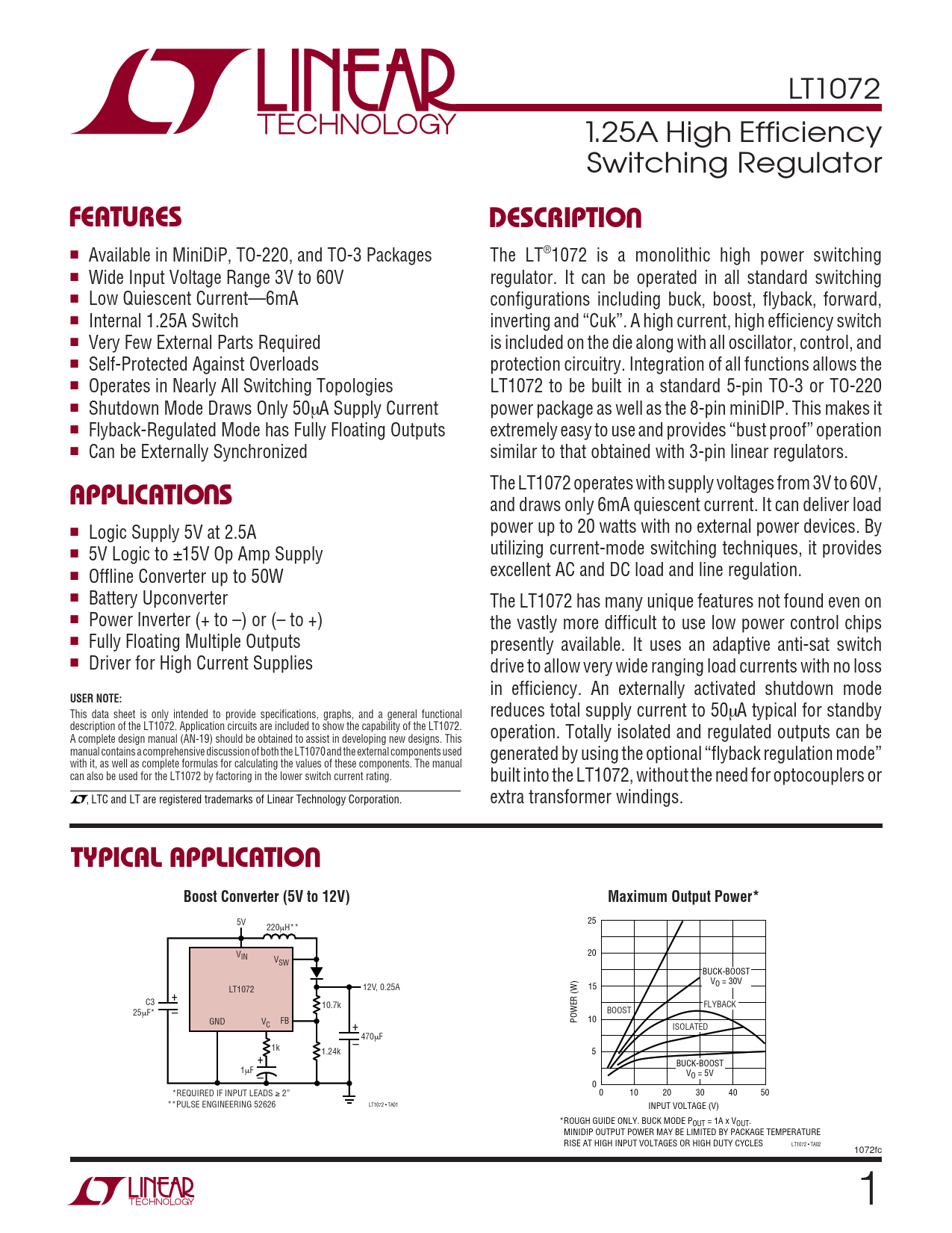

U TYPICAL APPLICATIO Boost Converter (5V to 12V) Maximum Output Power*
5V 25 220µH** V 20 IN VSW BUCK-BOOST VO = 30V LT1072 12V, 0.25A 15 + C3 10.7k FLYBACK 25µF* – BOOST GND V FB POWER (W) 10 C + ISOLATED 470µF 1k – 1.24k 5 + BUCK-BOOST 1µF – VO = 5V 0 *REQUIRED IF INPUT LEADS ≥ 2” 0 10 20 30 40 50 **PULSE ENGINEERING 52626 LT1072 • TA01 INPUT VOLTAGE (V) *ROUGH GUIDE ONLY. BUCK MODE POUT = 1A x VOUT. MINIDIP OUTPUT POWER MAY BE LIMITED BY PACKAGE TEMPERATURE RISE AT HIGH INPUT VOLTAGES OR HIGH DUTY CYCLES LT1072 • TA02 1072fc 1
