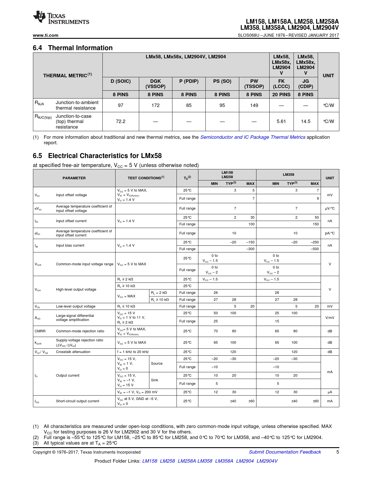

LM158,. LM158A, LM258. , LM258A. LM358,. LM358A,. LM2904. , LM2904V. www.ti.com. 6.4 Thermal Information. LMx58, LMx58x, LM2904V, LM2904
LM158, LM158A, LM258 , LM258A LM358, LM358A, LM2904 , LM2904V www.ti.com 6.4 Thermal Information LMx58, LMx58x, LM2904V, LM2904
SLOS068U – JUNE 1976 – REVISED JANUARY 2017
6.4 Thermal Information LMx58, LMx58x, LM2904V, LM2904 LMx58, LMx58, LMx58x, LMx58x, LM2904 LM2904 V V THERMAL METRIC(1) UNIT D (SOIC) DGK P (PDIP) PS (SO) PW FK JG (VSSOP) (TSSOP) (LCCC) (CDIP) 8 PINS 8 PINS 8 PINS 8 PINS 8 PINS 20 PINS 8 PINS
RθJA Junction-to-ambient 97 172 85 95 149 — — °C/W thermal resistance RθJC(top) Junction-to-case (top) thermal 72.2 — — — — 5.61 14.5 °C/W resistance (1) For more information about traditional and new thermal metrics, see the Semiconductor and IC Package Thermal Metrics application report.
6.5 Electrical Characteristics for LMx58
at specified free-air temperature, VCC = 5 V (unless otherwise noted)
LM158 LM358 PARAMETER TEST CONDITIONS(1) T (2) LM258 A UNIT MIN TYP(3) MAX MIN TYP(3) MAX
