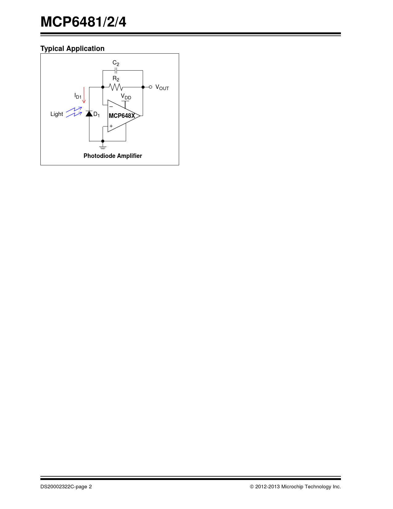

DescriptionThe Microchip’s MCP6481 operational amplifiers (op amps) has low input bias current (150 pA, typical at 125°C) and rail-to-rail input and output operation
Pages / Page50 / 2 — MCP6481/2/4. Typical Application. MCP648X. Photodiode Amplifier
MCP6481/2/4 Typical Application MCP648X Photodiode Amplifier
C2 R2 VOUT ID1 VDD – Light D1
MCP648X
