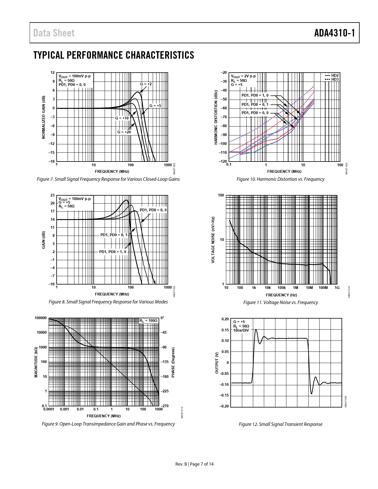

Data Sheet. ADA4310-1. TYPICAL PERFORMANCE CHARACTERISTICS. –20. VOUT = 100mV p-p. VOUT = 2V p-p. HD2. HD3. 9 RL = 50Ω. –30 RL = 50Ω
Data Sheet ADA4310-1 TYPICAL PERFORMANCE CHARACTERISTICS –20 VOUT = 100mV p-p VOUT = 2V p-p HD2 HD3 9 RL = 50Ω –30 RL = 50Ω
Data Sheet ADA4310-1 TYPICAL PERFORMANCE CHARACTERISTICS 12 –20 VOUT = 100mV p-p VOUT = 2V p-p HD2 HD3 9 RL = 50Ω –30 RL = 50Ω PD1, PD0 = 0, 0 G = +2 G = +5 6 –40 ) Bc) PD1, PD0 = 1, 0 B d 3 –50 (d N ( N G = +5 IO PD1, PD0 = 0, 1 AI 0 –60 RT G PD1, PD0 = 0, 0 D O T E –3 G = +10 S –70 IZ L A –6 C DI –80 NI RM G = +20 O –9 –90 NO RM –12 HA –100 –15 –110 –18 –120 1
22
10 100 1000 0.1
23
1 10 100
0 0 7- 7- 02
FREQUENCY (MHz)
02
FREQUENCY (MHz)
06 06 Figure 7. Small Signal Frequency Response for Various Closed-Loop Gains Figure 10. Harmonic Distortion vs. Frequency
23 100 VOUT = 100mV p-p 20 G = +5 RL = 50Ω PD1, PD0 = 0, 0 17 ) 14 /√Hz 11 V n ) B d 8 PD1, PD0 = 0, 1 ( ISE ( O 10 IN 5 GA E N G 2 PD1, PD0 = 1, 0 A T L –1 O V –4 –7 –10 1 1
21
10 100 1000 10 100 1k 10k 100k 1M 10M 100M 1G
0 12 0 7- 7- 02
FREQUENCY (MHz) FREQUENCY (Hz)
02 06 06 Figure 8. Small Signal Frequency Response for Various Modes Figure 11. Voltage Noise vs. Frequency
100000 R 0.20 L = 100Ω G = +5 RL = 50Ω 0.15 10ns/DIV 10000 –45 0.10 ) 1000 –90 kΩ 0.05 ( ) rees) V eg ( T UDE 100 –135 T U 0 NI SE (D TP AG A OU –0.05 M 10 –180 PH –0.10 1 –225 –0.15
20 0 7-
0.1 –270
02
–0.20
06
0.0001 0.001 0.01 0.1 1 10 100 1000
013
FREQUENCY (MHz)
06027- Figure 9. Open-Loop Transimpedance Gain and Phase vs. Frequency Figure 12. Small Signal Transient Response Rev. B | Page 7 of 14 Document Outline FEATURES APPLICATIONS PIN CONFIGURATIONS GENERAL DESCRIPTION REVISION HISTORY SPECIFICATIONS ABSOLUTE MAXIMUM RATINGS THERMAL RESISTANCE Maximum Power Dissipation ESD CAUTION PIN CONFIGURATIONS AND FUNCTION DESCRIPTIONS TYPICAL PERFORMANCE CHARACTERISTICS THEORY OF OPERATION APPLICATION INFORMATION FEEDBACK RESISTOR SELECTION POWER CONTROL MODES OF OPERATION EXPOSED THERMAL PAD CONNECTIONS POWER LINE APPLICATION BOARD LAYOUT POWER SUPPLY BYPASSING OUTLINE DIMENSIONS ORDERING GUIDE
