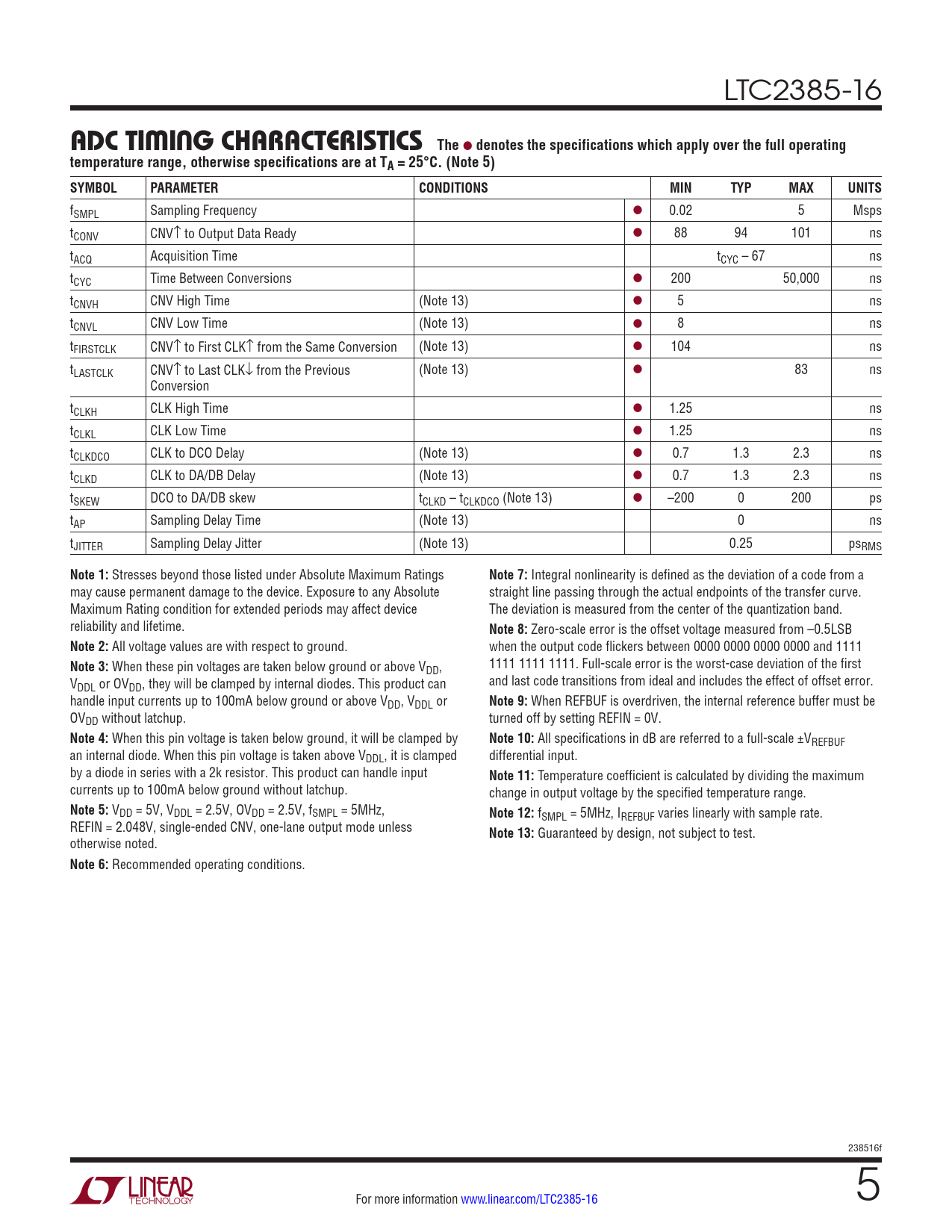

ADC. TIMING CHARACTERISTICS The. denotes the specifications which apply over the full operating
ADC TIMING CHARACTERISTICS The denotes the specifications which apply over the full operating
LTC2385-16
l
denotes the specifications which apply over the full operating temperature range, otherwise specifications are at TA = 25°C. (Note 5) SYMBOL PARAMETER CONDITIONS MIN TYP MAX UNITS
fSMPL Sampling Frequency l 0.02 5 Msps tCONV CNV↑ to Output Data Ready l 88 94 101 ns tACQ Acquisition Time tCYC – 67 ns tCYC Time Between Conversions l 200 50,000 ns tCNVH CNV High Time (Note 13) l 5 ns tCNVL CNV Low Time (Note 13) l 8 ns tFIRSTCLK CNV↑ to First CLK↑ from the Same Conversion (Note 13) l 104 ns tLASTCLK CNV↑ to Last CLK↓ from the Previous (Note 13) l 83 ns Conversion tCLKH CLK High Time l 1.25 ns tCLKL CLK Low Time l 1.25 ns tCLKDCO CLK to DCO Delay (Note 13) l 0.7 1.3 2.3 ns tCLKD CLK to DA/DB Delay (Note 13) l 0.7 1.3 2.3 ns tSKEW DCO to DA/DB skew tCLKD – tCLKDCO (Note 13) l –200 0 200 ps tAP Sampling Delay Time (Note 13) 0 ns tJITTER Sampling Delay Jitter (Note 13) 0.25 psRMS
Note 1:
Note 7:
Integral nonlinearity is defined as the deviation of a code from a may cause permanent damage to the device. Exposure to any Absolute straight line passing through the actual endpoints of the transfer curve. Maximum Rating condition for extended periods may affect device The deviation is measured from the center of the quantization band. reliability and lifetime.
Note 8:
Zero-scale error is the offset voltage measured from –0.5LSB
Note 2:
All voltage values are with respect to ground. when the output code flickers between 0000 0000 0000 0000 and 1111
Note 3:
When these pin voltages are taken below ground or above V 1111 1111 1111. Full-scale error is the worst-case deviation of the first DD, V and last code transitions from ideal and includes the effect of offset error. DDL or OVDD, they will be clamped by internal diodes. This product can handle input currents up to 100mA below ground or above VDD, VDDL or
Note 9:
When REFBUF is overdriven, the internal reference buffer must be OVDD without latchup. turned off by setting REFIN = 0V.
Note 4:
When this pin voltage is taken below ground, it will be clamped by
Note 10:
All specifications in dB are referred to a full-scale ±VREFBUF an internal diode. When this pin voltage is taken above VDDL, it is clamped differential input. by a diode in series with a 2k resistor. This product can handle input
Note 11:
Temperature coefficient is calculated by dividing the maximum currents up to 100mA below ground without latchup. change in output voltage by the specified temperature range.
Note 5:
VDD = 5V, VDDL = 2.5V, OVDD = 2.5V, fSMPL = 5MHz,
Note 12:
fSMPL = 5MHz, IREFBUF varies linearly with sample rate. REFIN = 2.048V, single-ended CNV, one-lane output mode unless
Note 13:
Guaranteed by design, not subject to test. otherwise noted.
Note 6:
Recommended operating conditions. 238516f For more information www.linear.com/LTC2385-16 5 Document Outline Features Applications Description Typical Application Absolute Maximum Ratings Pin Configuration Order Information Electrical Characteristics Converter Characteristics Dynamic Accuracy Internal Reference Characteristics Reference Buffer Characteristics Digital Inputs and Digital Outputs Power Requirements ADC Timing Characteristics Typical Performance Characteristics Pin Functions Functional Block Diagram Timing Diagram Applications Information Package Description Typical Application Related Parts
