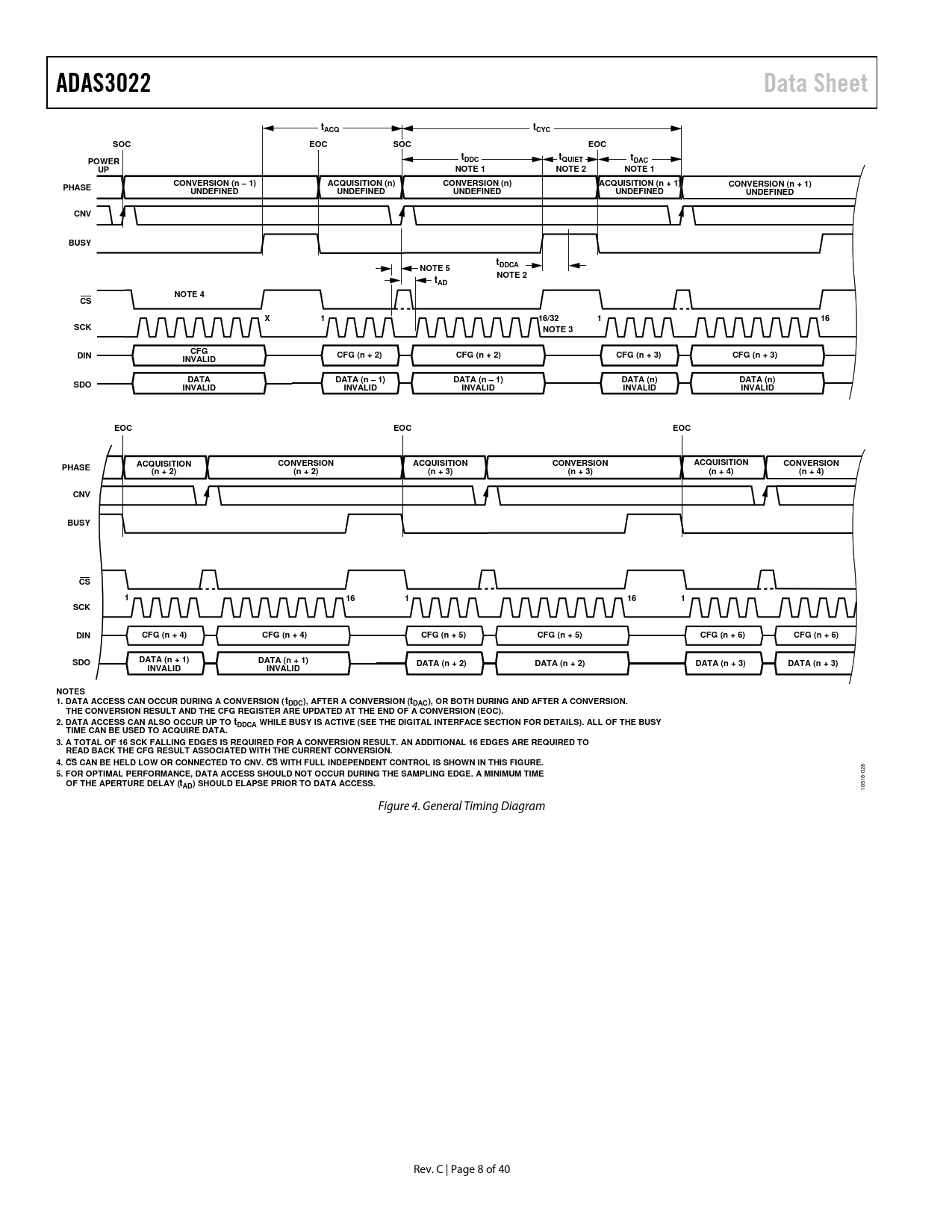

ADAS3022. Data Sheet. ACQ. CYC. SOC. EOC. POWER. DDC. QUIET. tDAC. NOTE 1. NOTE 2. CONVERSION (n – 1). ACQUISITION (n). CONVERSION (n)
ADAS3022 Data Sheet ACQ CYC SOC EOC POWER DDC QUIET tDAC NOTE 1 NOTE 2 CONVERSION (n – 1) ACQUISITION (n) CONVERSION (n)
ADAS3022 Data Sheet t t ACQ CYC SOC EOC SOC EOC t t POWER DDC QUIET tDAC UP NOTE 1 NOTE 2 NOTE 1 CONVERSION (n – 1) ACQUISITION (n) CONVERSION (n) ACQUISITION (n + 1) PHASE CONVERSION (n + 1) UNDEFINED UNDEFINED UNDEFINED UNDEFINED UNDEFINED CNV BUSY t NOTE 5 DDCA NOTE 2 tAD NOTE 4 CS X 1 16/32 1 16 SCK NOTE 3 CFG DIN CFG (n + 2) CFG (n + 2) CFG (n + 3) CFG (n + 3) INVALID DATA DATA (n – 1) DATA (n – 1) DATA (n) DATA (n) SDO INVALID INVALID INVALID INVALID INVALID EOC EOC EOC ACQUISITION CONVERSION ACQUISITION CONVERSION ACQUISITION CONVERSION PHASE (n + 2) (n + 2) (n + 3) (n + 3) (n + 4) (n + 4) CNV BUSY CS 1 16 1 16 1 SCK DIN CFG (n + 4) CFG (n + 4) CFG (n + 5) CFG (n + 5) CFG (n + 6) CFG (n + 6) DATA (n + 1) SDO DATA (n + 1) DATA (n + 2) DATA (n + 2) DATA (n + 3) DATA (n + 3) INVALID INVALID NOTES 1. DATA ACCESS CAN OCCUR DURING A CONVERSION ( tDDC), AFTER A CONVERSION (tDAC), OR BOTH DURING AND AFTER A CONVERSION. THE CONVERSION RESULT AND THE CFG REGISTER ARE UPDATED AT THE END OF A CONVERSION (EOC). 2. DATA ACCESS CAN ALSO OCCUR UP TO tDDCA WHILE BUSY IS ACTIVE (SEE THE DIGITAL INTERFACE SECTION FOR DETAILS). ALL OF THE BUSY TIME CAN BE USED TO ACQUIRE DATA. 3. A TOTAL OF 16 SCK FALLING EDGES IS REQUIRED FOR A CONVERSION RESULT. AN ADDITIONAL 16 EDGES ARE REQUIRED TO READ BACK THE CFG RESULT ASSOCIATED WITH THE CURRENT CONVERSION. 4. CS CAN BE HELD LOW OR CONNECTED TO CNV. CS WITH FULL INDEPENDENT CONTROL IS SHOWN IN THIS FIGURE. 5. FOR OPTIMAL PERFORMANCE, DATA ACCESS SHOULD NOT OCCUR DURING THE SAMPLING EDGE. A MINIMUM TIME
028
OF THE APERTURE DELAY (tAD) SHOULD ELAPSE PRIOR TO DATA ACCESS.
