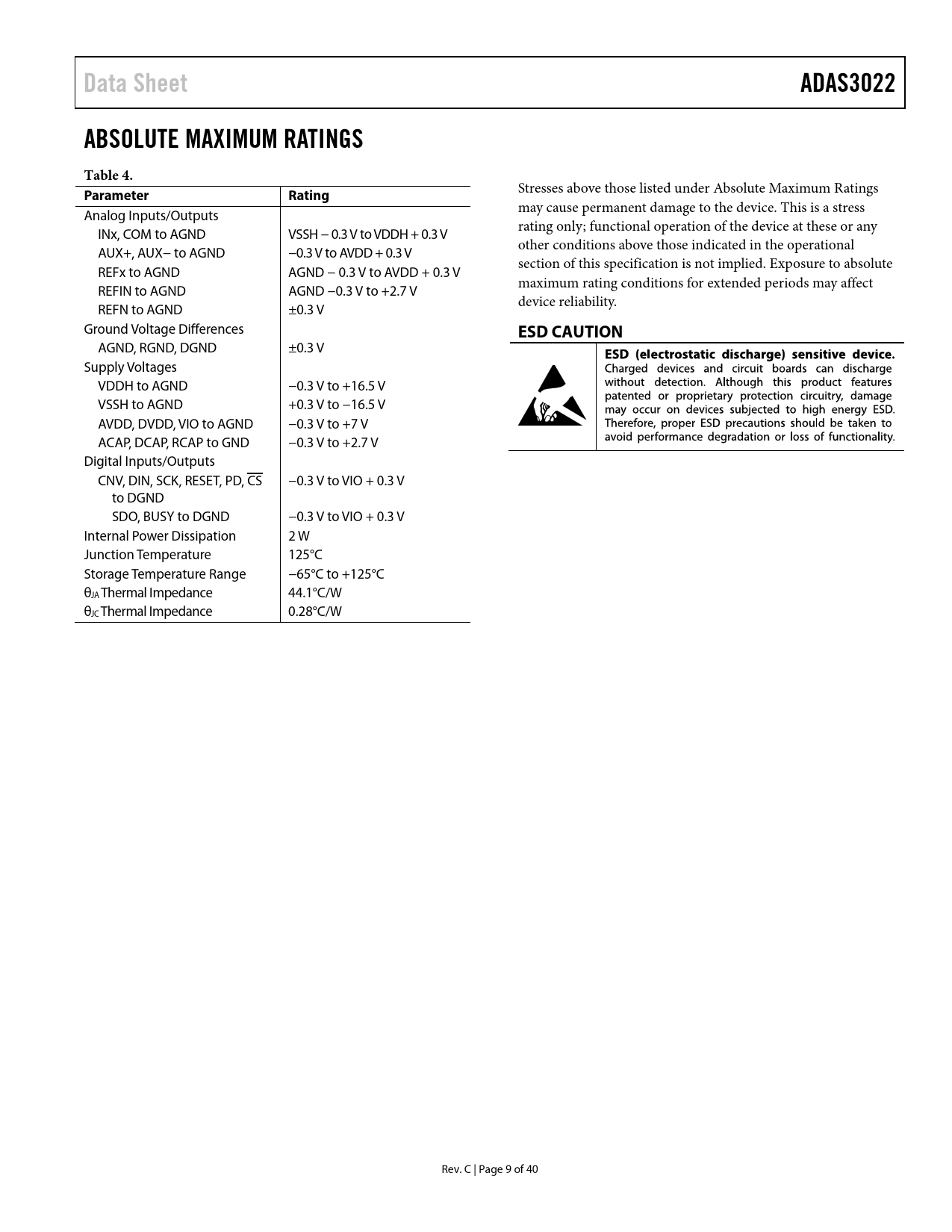

Data Sheet. ADAS3022. ABSOLUTE MAXIMUM RATINGS. Table 4. Parameter. Rating. ESD CAUTION
Data Sheet ADAS3022 ABSOLUTE MAXIMUM RATINGS Table 4 Parameter Rating ESD CAUTION
Data Sheet ADAS3022 ABSOLUTE MAXIMUM RATINGS Table 4. Parameter Rating
Stresses above those listed under Absolute Maximum Ratings Analog Inputs/Outputs may cause permanent damage to the device. This is a stress INx, COM to AGND VSSH − 0.3 V to VDDH + 0.3 V rating only; functional operation of the device at these or any other conditions above those indicated in the operational AUX+, AUX− to AGND −0.3 V to AVDD + 0.3 V section of this specification is not implied. Exposure to absolute REFx to AGND AGND − 0.3 V to AVDD + 0.3 V maximum rating conditions for extended periods may affect REFIN to AGND AGND −0.3 V to +2.7 V device reliability. REFN to AGND ±0.3 V Ground Voltage Differences
ESD CAUTION
AGND, RGND, DGND ±0.3 V Supply Voltages VDDH to AGND −0.3 V to +16.5 V VSSH to AGND +0.3 V to −16.5 V AVDD, DVDD, VIO to AGND −0.3 V to +7 V ACAP, DCAP, RCAP to GND −0.3 V to +2.7 V Digital Inputs/Outputs CNV, DIN, SCK, RESET, PD, CS −0.3 V to VIO + 0.3 V to DGND SDO, BUSY to DGND −0.3 V to VIO + 0.3 V Internal Power Dissipation 2 W Junction Temperature 125°C Storage Temperature Range −65°C to +125°C θJA Thermal Impedance 44.1°C/W θJC Thermal Impedance 0.28°C/W Rev. C | Page 9 of 40 Document Outline Features Applications General Description Functional Block Diagram Table of Contents Revision History Specifications Timing Specifications Absolute Maximum Ratings ESD Caution Pin Configuration and Function Descriptions Typical Performance Characteristics Terminology Theory of Operation Overview ADAS3022 Operation Transfer Function Typical Application Connection Diagram Analog Inputs Input Structure Programmable Gain Common-Mode Operating Range Fully Differential, Antiphase Signals with a Zero Common Mode Fully Differential, Antiphase Signals with a Nonzero Common Mode Differential, Nonantiphase Signals with a Zero Common Mode Single-Ended Signals with a Nonzero DC Offset (Asymmetrical) Single-Ended Signals with a 0 V DC Offset (Symmetrical) Multiplexer Channel Sequencer Auxiliary Input Channel Driver Amplifier Choice Voltage Reference Output/Input Internal Reference External Reference and Internal Buffer External Reference Reference Decoupling Power Supply Core Supplies High Voltage Supplies Power Dissipation Modes Fully Operational Mode Power-Down Mode Conversion Modes Warp Mode (CMS = 0) Normal Mode (CMS = 1, Default) Digital Interface Conversion Control CNV Rising Edge—Start of a Conversion (SOC) BUSY Falling Edge—End of a Conversion (EOC) Reset and Power-Down (PD) Inputs Serial Data Interface CPHA Sampling on the SCK Falling Edge Sampling on the SCK Rising Edge (Alternate Edge) CFG Readback General Considerations Data Access During Conversion—Maximum Throughput General Timing Configuration Register On Demand Conversion Mode Channel Sequencer Details INx and COM Inputs (MUX = 1, TEMPB = 1) INx and COM Inputs with AUX Inputs (MUX = 0, TEMPB = 1) INx and COM Inputs with Temperature Sensor (MUX = 1, TEMPB = 0) INx and COM Inputs with AUX Inputs and Temperature Sensor (MUX = 0, TEMPB = 0) Sequencer Modes Basic Sequencer Mode (SEQ = 11) Update During Sequence (SEQ = 01) Advanced Sequencer Mode (SEQ = 10) Outline Dimensions Ordering Guide
