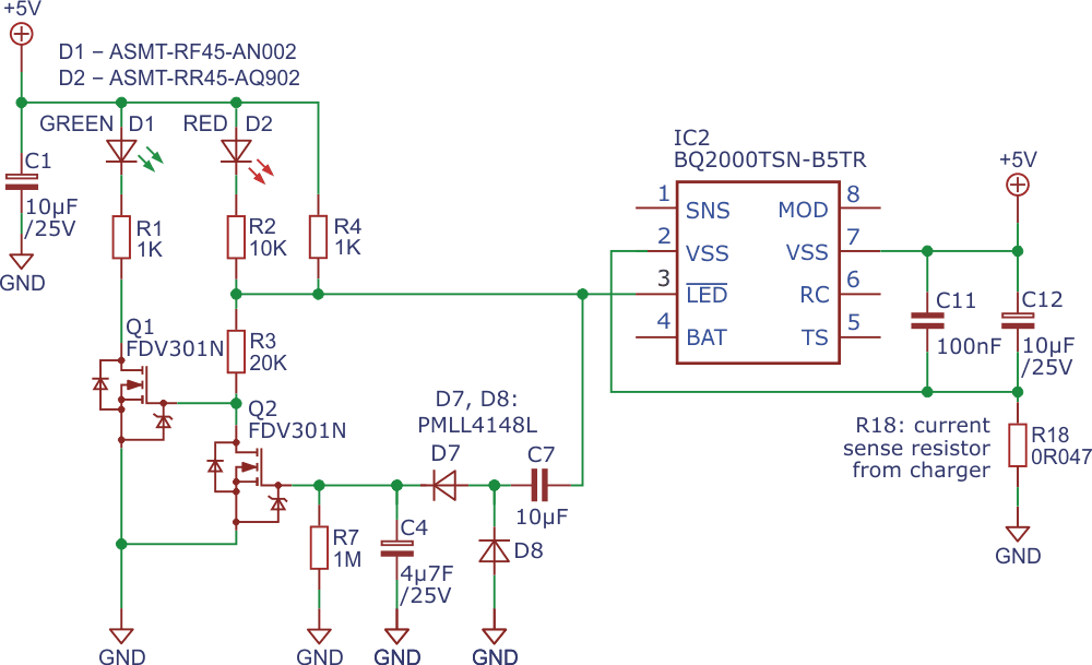

The simplest way would be to connect one LED to pin 3 for status indication. But for me it would be more logical to have two LEDs: a green one, which indicates that the charging process has successfully ended; and a red LED, which indicates charging in progression and fault mode.
I needed a cheap circuit so I decided to build a discrete circuit that does the job. Figure 1 depicts the LED circuitry of the battery charger.
The LED circuitry of the battery charger.
Figure 1. The LED circuitry of the battery charger.
The battery charger circuitry has been removed to make explanation easier. Each state of the circuit is described below:
State 1: LED pin output BQ2000 high impedance.
Q2 will not conduct because the gate input is pulled low via R7. +5 V will be applied via R4 to the cross section of R2 and R3 causing D2 to remain off since the voltage drop over D2 and R2 is too low. Q1 will conduct because +5 V will be available at the gate via R3 causing D1 to light up. C4 will not get charged because C7 functions as a DC blocking capacitor.
State 2: LED pin output BQ2000 low impedance.
R2 is pulled low via pin 3 of the BQ2000 causing D2 to light up. Q1 will not conduct anymore since the gate is pulled low via resistor R3 causing D1 to extinguish.
State 3: LED pin output BQ2000 1 Hz flash.
Figure 2 shows a screenshot of the 1 Hz signal at pin 3 of the BQ2000. C7 will conduct the block wave signal causing C4 to charge via diode D7. Q2 starts conducting as soon as the charge voltage of C4 reaches the gate source threshold voltage of Q2. This will cause the gate of Q1 to be pulled down via Q2. D1 will extinguish because Q1 is not conducting anymore.

C4 will charge at each low to high flank and then discharge. So it is important that the voltage over C4 will stay higher than the gate source threshold voltage of Q2. Else D1 will blink as well. This will be taken care of with the RC time t = RC of C4 and R7.
The block wave signal is also available at the cross point section of R2 and R3 causing D2 to blink at 1 Hz.

D8 is needed to charge C7 when the 1 Hz signal is low. Without D8 the polarity of the 1 Hz signal will be transformed to a negative signal.
