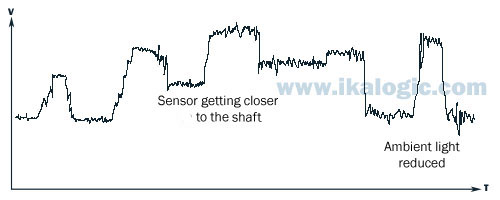

To reduce cost and hardware complexity, and to increase system flexibility, we decided to connect the IR sensor directly to the ATMEGA micro controller, and let it do all the signal processing. This was difficult because the signals coming from the photo-diode are very noisy, and are constantly biased by the ambient light. So the challenge was to build a system that would automatically adapt to ambient light and also adapt to the distance from the shaft being measured.
Figure below shows an example of the analog signals we could read from the senor. All the noise around each high/low transition is
Beside the fact that the signal is noisy, at each transition between ON and OFF (ON being when the shaft rotates and the sensor "sees" the reflective sticker), a huge amount of oscillation occur causing the controller to be totally confused!
We wanted to use the comparator that is integrated in the ATMEGA48, but due to all those factors, it was not possible, we needed to process the analog signals before even trying to count the cycles.

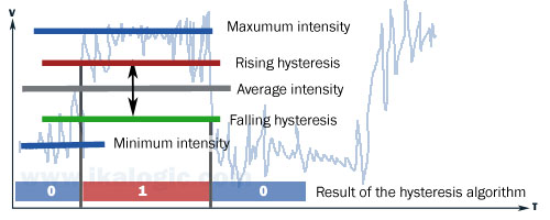

The solution we found was to constantly estimate the average intensity, based on the maximum and minimum intensities retrieved from the sensor, then "create" a hysteresis around that average intensity.
This hysteresis will be used to prevent multiple cycles counts during noisy High/Low transitions.
Here is how it works in more details: when the noisy signal is raising from a low state (no IR reflection) to a high state (IR re flexion), the algorithm will only consider the signal to be high if it crosses the "rising hysteresis" level shown on the graph, and will only consider the signal to be low if crosses the "falling hysteresis" level. This will prevent most possibilities of having errors caused by the noisy signal.
