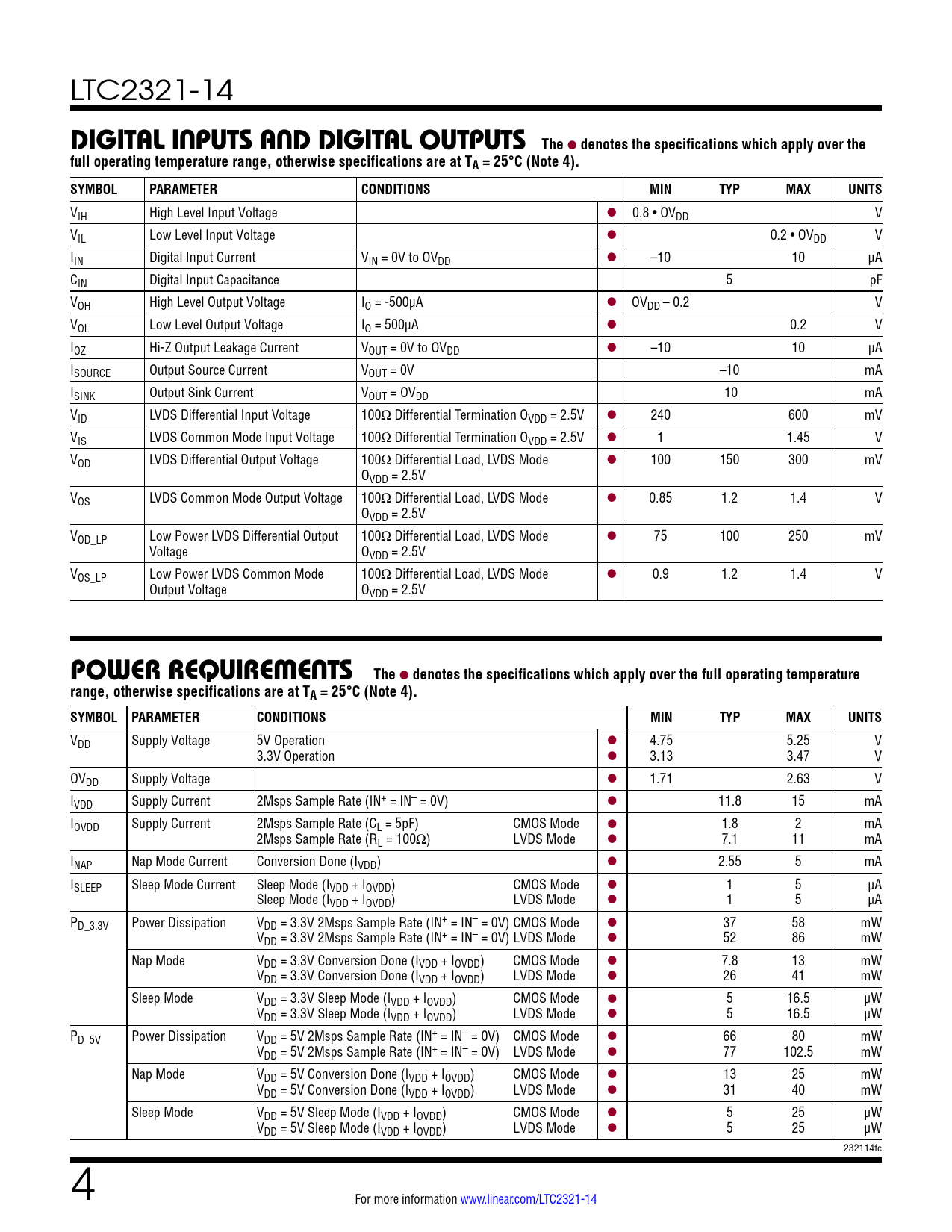

DigiTal inpuTs anD DigiTal ouTpuTs. The. denotes the specifications which apply over the
DigiTal inpuTs anD DigiTal ouTpuTs The denotes the specifications which apply over the
LTC2321-14
l
denotes the specifications which apply over the full operating temperature range, otherwise specifications are at TA = 25°C (Note 4). SYMBOL PARAMETER CONDITIONS MIN TYP MAX UNITS
VIH High Level Input Voltage l 0.8 • OVDD V VIL Low Level Input Voltage l 0.2 • OVDD V IIN Digital Input Current VIN = 0V to OVDD l –10 10 μA CIN Digital Input Capacitance 5 pF VOH High Level Output Voltage IO = -500µA l OVDD – 0.2 V VOL Low Level Output Voltage IO = 500µA l 0.2 V IOZ Hi-Z Output Leakage Current VOUT = 0V to OVDD l –10 10 µA ISOURCE Output Source Current VOUT = 0V –10 mA ISINK Output Sink Current VOUT = OVDD 10 mA VID LVDS Differential Input Voltage 100Ω Differential Termination OVDD = 2.5V l 240 600 mV VIS LVDS Common Mode Input Voltage 100Ω Differential Termination OVDD = 2.5V l 1 1.45 V VOD LVDS Differential Output Voltage 100Ω Differential Load, LVDS Mode l 100 150 300 mV OVDD = 2.5V VOS LVDS Common Mode Output Voltage 100Ω Differential Load, LVDS Mode l 0.85 1.2 1.4 V OVDD = 2.5V VOD_LP Low Power LVDS Differential Output 100Ω Differential Load, LVDS Mode l 75 100 250 mV Voltage OVDD = 2.5V VOS_LP Low Power LVDS Common Mode 100Ω Differential Load, LVDS Mode l 0.9 1.2 1.4 V Output Voltage OVDD = 2.5V
power requireMenTs The
l
