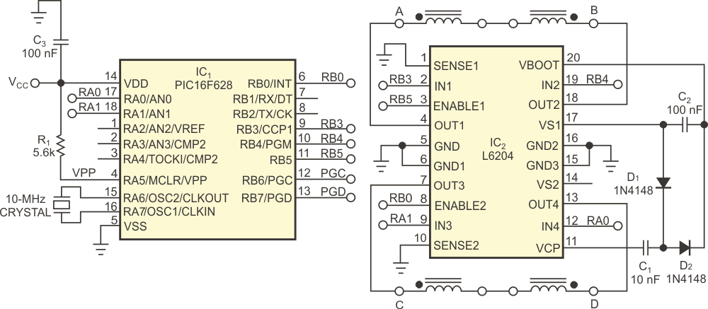

Multiple ICs can drive inductive loads. This circuit uses an L6204 dual full-bridge driver. Each bridge has four power-DMOS transistors with on-resistances of 1.2 Ω. A PIC16F628 microcontroller controls the switches of the dual-bridge driver (Figure 2). Typical waveforms show how each circuit is excited (Figure 3).
The circuit comprises a full-bridge driver and a microcontroller.
Figure 2. The circuit comprises a full-bridge driver and a microcontroller.
To ensure the correct driving of high-side drivers, the circuit supplies a voltage higher than the supply voltage at IC2’s Pin 20. External capacitors C1 and C2 and diodes D1 and D2 use a charge-pump method to produce this voltage. You can independently control the four half-bridges by means of the IN1, IN2, IN3, IN4, ENABLE1, and ENABLE2 inputs.
