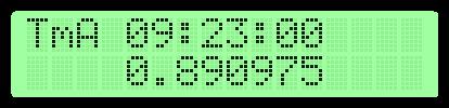

The clock display is a 2x16 LCD module. The first row always shows the currently selected timer. The second row is used to show either the Julian time, or the current menu selection:
The sixteen timers are named TmA, TmB and so on, through TmP. Here, TmA is the name of the timer, followed by the current time. The second row shows the same time in Julian format (useful for astronomy and other things). The keyboard looks like this:

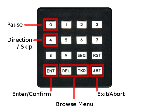

Not the best layout, but this is what I had on hand when I was making the clock. If you decide to build this project and have a keyboard with different layout, check Using Different Keyboard in the Code section.

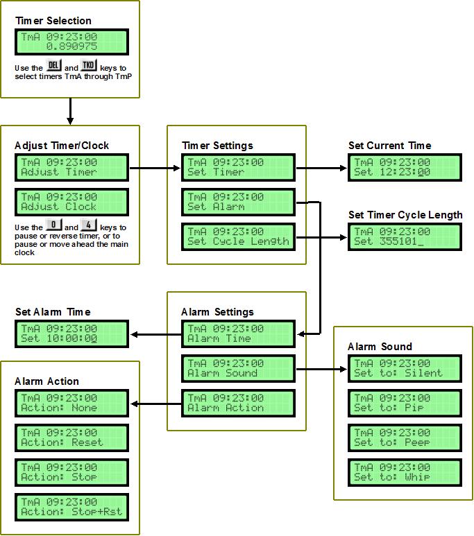

The user interface of the clock is organized in menus. Pressing the DEL and TKO buttons will let you browse through the entries of a menu. Pressing the ENT will select an entry (and perform the associated action with this entry - open another menu, set a value, etc). Going out of a menu is done by pressing the DEL button. This will bring the previous menu up. Here is a diagram of the clock menus, followed by detailed description of each menu:
Main Menu - Timer Selection
When the clock is just powered up, you are in the "Timer Selection" menu (the screenshot above). In this mode, you can browse through the 16 timers - TmA through TmP (as with any menu, use the TKO and DEL buttons to select timers). If you are not sure which menu you are in, pressing the ABT button several times will bring you to the main menu.
Adjusting the Time [select timer, ENT]
If you want to change something about a timer - to set up the time, adjust the timer rate, set up an alarm, etc. select the given timer and press the ENT button. This will bring the next menu, with two options:
When the Adjust Timer option is visible, you can use the 0 button to pause and restart the timer, and the 4 button to switch timer direction (forward or backward). This will affect only the currently selected timer.
When the Adjust Clock option is visible, you can make adjustments to the clock that will affect all timers. Pressing the 0 button to pause and restart the clock. Pressing 4 button will cause the clock to jump forward one second. This way you can adjust the correct time without resetting each timer independently.
Timer Settings [select timer, ENT]
Select a timer, and press the ENT button twice (once to get to the Adjust menu, and the second time to choose the Adjust Timer option). This will show you the next menu with the following options:
Selecting the Set Timer option and pressing ENT will show you a screen where you can enter the new time. Enter the time using the number keys. The new time will be set when you enter all six digits (HH:MM:SS) or when you press the ENT button. Pressing ABT at any time will abort the operation and the time will not be set.
If you select the Set Alarm option, this will let you set the alarm time, sound, and action. This menu is discussed later.
To change the timer to something other than the length of a standard Earth day (24 hours), enter the new length by selecting the Set Cycle Length option. For more details, and some sample values (for example, how to make a timer run on Mars time), check Setting the Timer Cycle Length in the How-To section. Confirm the new cycle length with the ENT button, or cancel the operation at any time by pressing the ABT button.
Alarm Settings [select timer, ENT, select "Set Alarm", ENT]
Each timer has an alarm associated with it. This menu will let you choose between the following options:
To set the alarm time, choose the Alarm Time option and press ENT. Enter the time. As usual, the ENT will confirm and the ABT will cancel the operation at any time.
Selecting the Alarm Sound option will bring you to a menu where you can choose between the following sounds: Pip, Peep, Whip and Silent. When activated, the alarm will play a short beeping sound, a long beeping sound, or something that sounds like Whiiiiip! If you select Silent, the alarm will not play any sound.
Finally, the Alarm Action option lets you choose what should happen to the timer once the alarm is activated. You have the following choice: None (no action, apart from the sound that is played), Reset (the current timer is reset to 00:00:00 and counting goes on), Stop (the current timer is stopped), and Stop+Rst (the timer is stopped and reset to 00:00:00).

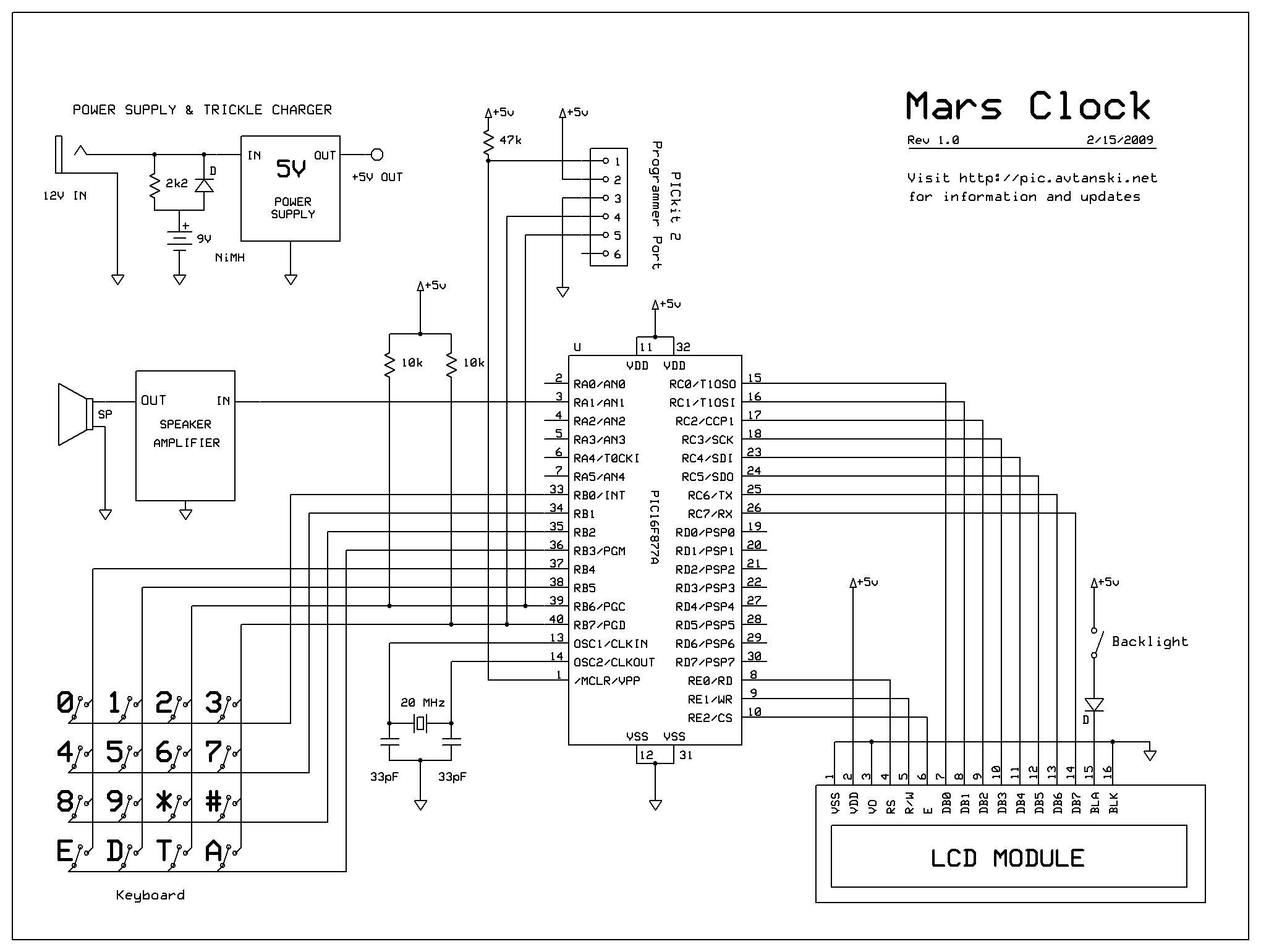

Schematics
click to enlarge
Download schematics in: [High Resolution PNG | Scalable Windows Metafile format (EMF) ]
Notes
  • The 5 V Power Supply block contains the voltage stabilizer and filtering capacitors from the power supply on the modem board.
  • The Speaker Amplifier block is the LM386-based amplifier circuit that was on the original modem board. The speaker is the internal modem speaker.
  • The PICkit 2 Programmer port is intended for reprogramming the microcontroller without disassembling the clock. The DB25 to 6-pin adapter (see the picture) is not shown.
  • If your keyboard has different layout than the one shown, refer to Using Different Keyboard in the Code section.
  • I used a Techstar 16 characters * 2 lines LCD Module with backlight. These modules are pretty standard, so almost any 16 x 2 LCD module will work. Backlight is a plus, but it is not mandatory.
