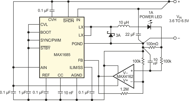

This miniature, 1 A, high-power LED driver operates on 3.6 to 6.5 V.
Figure 1. This miniature, 1 A, high-power LED driver operates on 3.6 to 6.5 V.

The designers of these circuits based them on the same concept: a fully integrated, single-die-IC switching regulator and a micropower operational amplifier. The op amp drives the 1.25 V feedback terminal on the IC. Although that node targets the topology of a standard voltage regulator, the op amp matches it to the much smaller current-sense voltage and the slightly different topology of a current regulator. None of the circuits requires the use of external power switches. The design eliminates the use of the large-valued filter capacitors you usually find in a switching regulator, because there is no need to smooth out high-frequency ripple in the LED current. Common to all circuits is the option of adding a dimming capability by introducing adjustable bias at an op-amp input through a resistor and a potentiometer powered from the internal regulator – the VD or CVL terminal, depending on the IC.
A high-frequency switching regulator powers the basic regulator circuit for LEDs (Figure 1). It operates with input voltages of 3.6 to 6.5 V, drives a single LED with currents as high as 1 A, and uses a current-sense resistor to control the current-regulation loop. The circuit of Figure 2 is similar, but, in place of a current-sense resistor, it employs the parasitic resistance of the inductor as a current-sensing element. Like the circuit in Figure 1, it operates with 3.6 to 6.5 V inputs and drives one LED with currents as high as 1 A.
