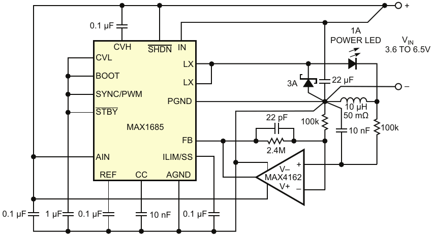

Similar to the circuit in Figure 1, this miniature, 1 A, LED driver operates on 3.6 to 6.5 V but requires no current-sense resistor
Alfredo Saab, Steve Logan

High-power LED drivers require no external switches
Figure 1. This miniature, 1 A, high-power LED driver operates on 3.6 to 6.5 V
Figure 2. Similar to the circuit in Figure 1, this miniature, 1 A, LED driver operates on 3.6 to 6.5 V but requires no current-sense resistor
Figure 3. Another miniature, high-power LED driver delivers 0.5 A and operates on 2.7 to 6.5 V
Figure 4. This miniature, 1 A, LED-driver circuit operates on 8 to 50 V and drives as many as three LEDs in series
