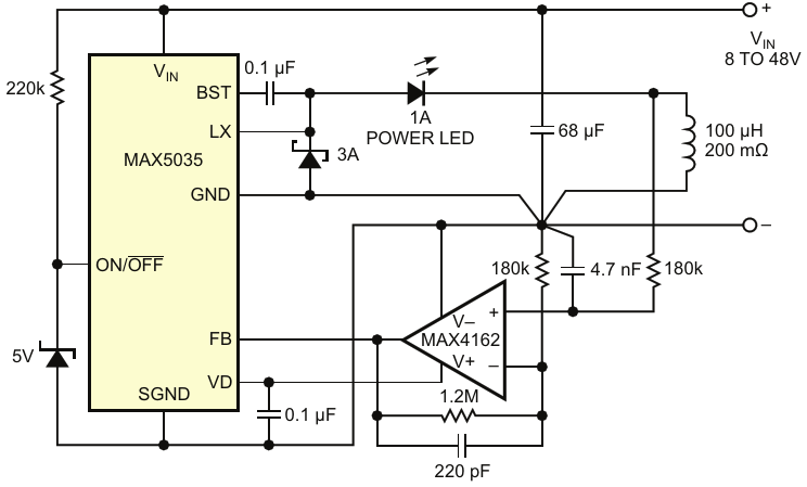

Otherwise similar to the circuit in Figure 4, this circuit requires no sense resistor

Figure 5. Otherwise similar to the circuit in Figure 4, this circuit requires no sense resistor
