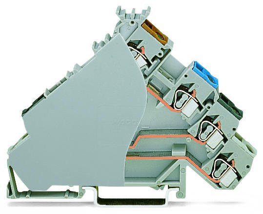

Datasheet Wago 280-588/280-320
4-conductor sensor terminal block; for PNP (positive) switching sensors; for fuse plugs; with gray end plate; with colored conductor entries; 2.5 mm²; CAGE CLAMP
Parametrics
| Actuation type | Operating tool |
| Color | gray |
| Connectable conductor materials | Copper |
| Connection technology | CAGE CLAMP® |
| Страна происхождения | DE |
| Depth | 90.5 mm / 3.563 inch |
| Design | angled |
| Fine-stranded conductor | 0.08 … 2.5 mm² / 28 … 12 AWG |
| Fire load | 0.348 MJ |
| Global Trade Item Number (GTIN) | 4045454559489 |
| Height from upper-edge of DIN-35 rail | 63.5 mm / 2.5 inch |
| Insulating material | Polyamide 66 (PA 66) |
| Legend (ratings) | (III / 3) ≙ Overvoltage category III / Pollution degree 3 |
| Marking level | Center marking |
| Number of levels | 4 |
| Product Group | 1 (Rail Mounted Terminal Blocks) |
| Rated current | 5 A |
| Rated current (2) | 6.3 A |
| Rated voltage (III / 3) | 125 V |
| Rated voltage (III / 3) 2 | 250 V |
| Solid conductor | 0.08 … 2.5 mm² / 28 … 12 AWG |
| Strip length | 8 … 9 mm / 0.31 … 0.35 Inch |
| Total number of connection points | 6 |
| Total number of potentials | 5 |
| Type of mounting | DIN-35 rail |
| Type of wiring | Front-entry wiring |
| Weight | 21 g |
| Width | 6 mm / 0.236 inch |
