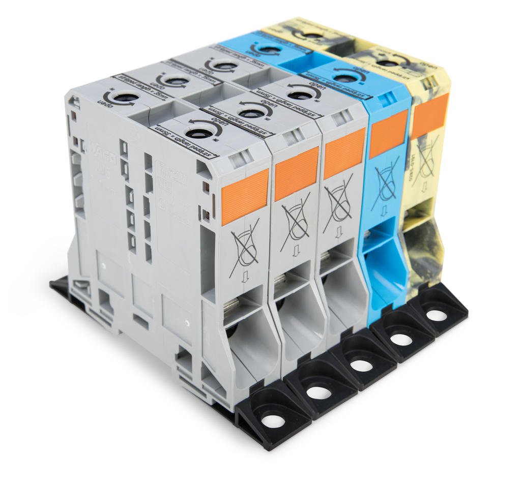

Datasheet Wago 285-188
Three phase set; with 95 mm² high-current tbs; with fixing flanges; copper; 95 mm²; POWER CAGE CLAMP
Parametrics
| Actuation type | Operating tool |
| Color | multicoloured |
| Connectable conductor materials | Copper |
| Connection technology | POWER CAGE CLAMP |
| Страна происхождения | PL |
| Depth | 145 mm / 5.709 inch |
| Design | horizontal |
| Fine-stranded conductor | 25 … 95 mm² / 4 … 4/0 AWG |
| Global Trade Item Number (GTIN) | 4055143774918 |
| Height from upper-edge of DIN-35 rail | 108 mm / 4.252 inch |
| Insulating material | Polyamide 66 (PA 66) |
| Marking level | Side marking |
| Mounting type | Mounting flange |
| Number of levels | 1 |
| Rated impulse voltage (III / 3) | 8 kV |
| Rated voltage (III / 3) | 1000 V |
| Solid conductor | 25 … 95 mm² / 4 … 4/0 AWG |
| Strip length | 35 mm / 1.38 Inch |
| Total number of connection points | 10 |
| Total number of potentials | 5 |
| Type of wiring | Side-entry wiring |
| Weight | 1351.045 g |
