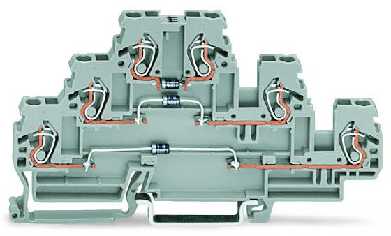

Datasheet Wago 870-596/281-674
Triple-deck diode terminal block; with 3 diodes 1N4007
Parametrics
| Actuation type | Operating tool |
| Color | gray |
| Connectable conductor materials | Copper |
| Connection technology | CAGE CLAMP® |
| Страна происхождения | DE |
| Depth | 106 mm / 4.173 inch |
| Design | horizontal |
| Fine-stranded conductor | 0.08 … 4 mm² / 28 … 12 AWG |
| Fire load | 0.305 MJ |
| Global Trade Item Number (GTIN) | 4045454198855 |
| Height from upper-edge of DIN-35 rail | 52.5 mm / 2.067 inch |
| Insulating material | Polyamide 66 (PA 66) |
| Marking level | Side marking |
| Nominal voltage | 250 V |
| Number of levels | 3 |
| Product Group | 16 (Rail Mounted Terminal Block with CCC) |
| Reverse voltage | 1000 V |
| Solid conductor | 0.08 … 2.5 mm² / 28 … 12 AWG |
| Strip length | 6 … 7 mm / 0.24 … 0.28 Inch |
| Total number of connection points | 6 |
| Total number of potentials | 2 |
| Type of mounting | DIN-35 rail |
| Type of wiring | Front-entry wiring |
| Weight | 16.6 g |
| Width | 5 mm / 0.197 inch |
