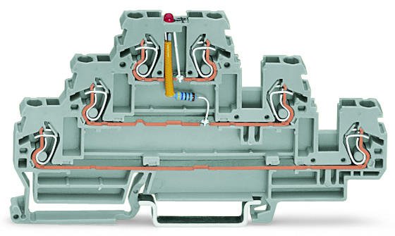

Triple-deck LED terminal block; red LED (PN); rail-mount; 4-conductor; 5 mm wide; gray
