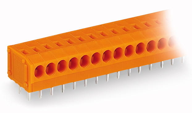

Datasheet Wago 235-107/330-000
PCB terminal block; 1.5 mm²; Pin spacing 3.81 mm; 7-pole; PUSH WIRE
Parametrics
| Actuation type | Operating tool |
| Clamping spring material | Chrome nickel spring steel (CrNi) |
| Color | orange |
| Connection technology | PUSH WIRE® |
| Contact material | Electrolytic copper (Ecu) |
| Contact plating | tin-plated |
| Страна происхождения | CH |
| Depth | 12.5 mm / 0.492 inch |
| Drilled hole diameter (tolerance) | 1(+ 0.1) mm |
| Fine-stranded conductor with ferrule with plastic collar | 0.25 … 0.75 mm² |
| Fine-stranded conductor with ferrule without plastic collar | 0.25 … 0.75 mm² |
| Fire load | 0.06 MJ |
| Flammability class per UL94 | V0 |
| Global Trade Item Number (GTIN) | 4044918828741 |
| Height | 12.8 mm / 0.504 inch |
| Height from the surface | 9.2 mm / 0.362 inch |
| Insulating material | Polyamide 66 (PA 66) |
| Legend (ratings) | (III / 2) ≙ Overvoltage category III / Pollution degree 2 |
| Limit temperature range | -60 … +105 °C |
| Material group | I |
| Number of Poles | 7 |
| Number of connection types | 1 |
| Number of levels | 1 |
| Number of solder pins per potential | 2 |
| PCB contact | THT |
| Pin spacing | 3.81 mm (0.15 inch) |
| Product Group | 4 (Printed Circuit) |
| Rated current | 17.5 A |
| Rated impulse voltage (II / 2) | 4 kV |
| Rated impulse voltage (III / 2) | 4 kV |
| Rated impulse voltage (III / 3) | 4 kV |
| Rated voltage (II / 2) | 500 V |
| Rated voltage (III / 2) | 320 V |
| Rated voltage (III / 3) | 200 V |
| Solder pin arrangement | over the entire terminal strip, in line |
| Solder pin dimensions | 0.8 x 0.4 mm |
| Solder pin length | 3.6 mm |
| Solid conductor | 0.5 … 1.5 mm² / 20 … 16 AWG |
| Strip length | 9 … 10 mm / 0.35 … 0.39 Inch |
| Total number of connection points | 7 |
| Total number of potentials | 7 |
| Weight | 3.756 g |
| Width | 28.17 mm / 1.109 inch |
