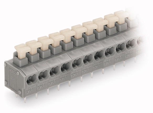

Datasheet Wago 235-459/331-000
2-Leiter-Leiterplattenklemme; Betätigungsdrücker; 0,75 mm²; Rastermaß 5/5,08 mm; 9-polig; Push-in CAGE CLAMP
Parametrics
| Actuation type | Push-button |
| Clamping spring material | Chrome nickel spring steel (CrNi) |
| Color | grau |
| Connection technology | PUSH WIRE® |
| Contact material | Electrolytic copper (Ecu) |
| Contact plating | tin-plated |
| Страна происхождения | CH |
| Depth | 12.5 mm / 0.492 inch |
| Drilled hole diameter (tolerance) | 1(+ 0.1) mm |
| Flammability class per UL94 | V0 |
| Height | 19.1 mm / 0.752 inch |
| Height from the surface | 15.5 mm / 0.61 inch |
| Insulating material | Polyamide 66 (PA 66) |
| Legend (ratings) | (III / 2) ≙ Overvoltage category III / Pollution degree 2 |
| Limit temperature range | -60 … +105 °C |
| Material group | I |
| Number of Poles | 9 |
| Number of connection types | 1 |
| Number of levels | 1 |
| Number of solder pins per potential | 2 |
| PCB contact | THT |
| Pin spacing | 5/5.08 mm / 0.197/0.2 inch |
| Product Group | 4 (Printed Circuit) |
| Rated current | 10 A |
| Rated impulse voltage (II / 2) | 4 kV |
| Rated impulse voltage (III / 2) | 4 kV |
| Rated impulse voltage (III / 3) | 4 kV |
| Rated voltage (II / 2) | 630 V |
| Rated voltage (III / 2) | 320 V |
| Rated voltage (III / 3) | 250 V |
| Solder pin arrangement | over the entire terminal strip, in line |
| Solder pin dimensions | 0.8 x 0.4 mm |
| Solder pin length | 3.6 mm |
| Solid conductor | 0.2 … 0.75 mm² / 24 … 18 AWG |
| Strip length | 9 … 10 mm / 0.35 … 0.39 Inch |
| Total number of connection points | 18 |
| Total number of potentials | 9 |
| Width | 46.5 mm / 1.831 inch |
