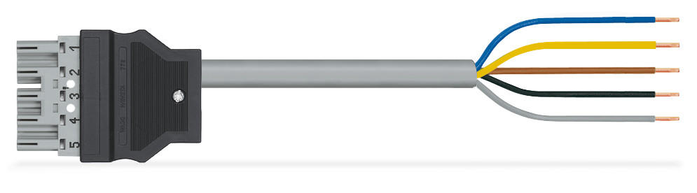

Datasheet Wago 771-8995/207-303
pre-assembled connecting cable; Eca; Plug/open-ended; 5-pole; Cod. B; 3 m
Detailed Description
Parametrics
| Coding | B |
| Color | gray |
| Color of sheathed cable | gray |
| Conductor preparation | tip-bonded |
| Connection type | Plug - free end |
| Connector color | gray |
| Contact material | Copper or copper alloy, surface-treated |
| Страна происхождения | DE |
| Cross section of single conductor | 2.5 mm² |
| Degree of protection | IP20 |
| Durchmesser der Mantelleitung | 11.2 … 13.9 mm |
| Fire load | 9.741 MJ |
| Flammability class per UL94 | V0 |
| Global Trade Item Number (GTIN) | 4050821671169 |
| Insulating material | Polyamide 66 (PA 66) |
| Legend (ratings) | (III / 3) ≙ Overvoltage category III / Pollution degree 3 |
| Locking lever | no |
| Locking of plug-in connection | locking lever |
| Marking | 1 2 3 4 5 |
| Mating force of a plug-in connection | approx. 20 … 70 N (depending on pole number) |
| Number of Poles | 5 |
| Pin spacing | 10 mm (0.394 inch) |
| Potential marking | 1 2 3 4 5 |
| Printing color of mating face | black |
| Printing color of sheathed cable | black |
| Printing color of strain relief | white |
| Rated current | 20 A |
| Rated impulse voltage (III / 3) | 6 kV |
| Rated voltage (III / 3) | 400 V |
| Reaction to fire class per EN 50575 | Eca |
| Retention force of a plug-in connection | when locked: > 80N |
| Sheath material | PVC |
| Strain relief color | black |
| Strip length | 55 mm |
| Surrounding air (operating) temperature | -35 … 85 °C |
| Total length | 3 m |
| Total number of potentials | 5 |
| Type of cable | Control line 5 x 2.5 |
| Type of cable assembly | Connecting cable |
| Unmating force of a plug-in connection | when unlocked: approx. 20 … 70 N (depending on pole number) |
| Weight | 690.857 g |
