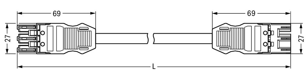

Datasheet Wago 771-9273/016-605
pre-assembled interconnecting cable; B2ca; Socket/plug; 3-pole; Cod. S; 6 m
Detailed Description
Parametrics
| Coding | S |
| Color | brown |
| Color of sheathed cable | black |
| Connection type | Socket - Plug |
| Connector color | brown |
| Contact material | Copper or copper alloy, surface-treated |
| Страна происхождения | DE |
| Cross section of single conductor | 1.5 mm² |
| Degree of protection | IP20 |
| Durchmesser der Mantelleitung | 7.4 … 9.4 mm |
| Flammability class per UL94 | V0 |
| Global Trade Item Number (GTIN) | 4055143796798 |
| Halogen-free | Yes |
| Insulating material | Polyamide 66 (PA 66) |
| Legend (ratings) | (III / 3) ≙ Overvoltage category III / Pollution degree 3 |
| Locking lever | no |
| Locking of plug-in connection | locking lever |
| Marking | 1 2 L |
| Mating force of a plug-in connection | approx. 20 … 70 N (depending on pole number) |
| Mismating protection | Yes |
| Number of Poles | 3 |
| Packaging type | not packed |
| Pin spacing | 10 mm (0.394 inch) |
| Potential marking | 1 2 L |
| Printing color of mating face | white |
| Printing color of sheathed cable | white |
| Printing color of strain relief | white |
| Rated current | 16 A |
| Rated impulse voltage (III / 3) | 4 kV |
| Rated voltage (III / 3) | 250 V |
| Reaction to fire class per EN 50575 | B2ca |
| Retention force of a plug-in connection | when locked: > 80N |
| Strain relief color | black |
| Surrounding air (operating) temperature | -35 … 85 °C |
| Total length | 6 m |
| Total number of potentials | 3 |
| Type of cable | H05Z1Z1-F CPR 3G1.5 |
| Type of cable assembly | Interconnecting cable |
| Unmating force of a plug-in connection | when unlocked: approx. 20 … 70 N (depending on pole number) |
| Weight | 625.265 g |
