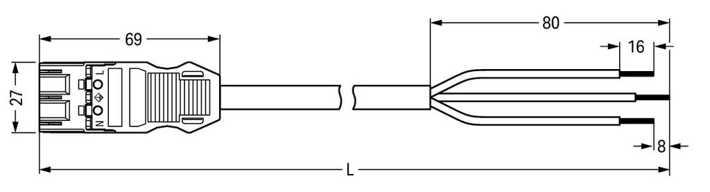

pre-assembled connecting cable; Eca; Plug/open-ended; 3-pole; Cod. A; H05VV-F 3G 1.5 mm²; 7 m
Detailed Description
Parametrics
| Coding | A |
| Color | black |
| Color of sheathed cable | black |
| Conductor preparation | tip-bonded |
| Connection type | Plug - free end |
| Connector color | black |
| Contact material | Copper or copper alloy, surface-treated |
| Страна происхождения | DE |
| Cross section of single conductor | 1.5 mm² |
| Degree of protection | IP20 |
| Durchmesser der Mantelleitung | 7.4 … 9.4 mm |
| Fire load | 13.626 MJ |
| Flammability class per UL94 | V0 |
| Global Trade Item Number (GTIN) | 4045454918132 |
| Ground function | with preceding GND contact |
| Insulating material | Polyamide 66 (PA 66) |
| Legend (ratings) | (III / 3) ≙ Overvoltage category III / Pollution degree 3 |
| Locking lever | no |
| Locking of plug-in connection | locking lever |
| Marking | L ⏚ N |
| Mating force of a plug-in connection | approx. 20 … 70 N (depending on pole number) |
| Mismating protection | Yes |
| Number of Poles | 3 |
| Pin spacing | 10 mm (0.394 inch) |
| Potential marking | L ⏚ N |
| Printing color of mating face | white |
| Printing color of sheathed cable | white |
| Printing color of strain relief | white |
| Rated current | 16 A |
| Rated impulse voltage (III / 3) | 4 kV |
| Rated voltage (III / 3) | 250 V |
| Reaction to fire class per EN 50575 | Eca |
| Retention force of a plug-in connection | when locked: > 80N |
| Sheath material | PVC |
| Strain relief color | black |
| Strip length | 80 mm |
| Surrounding air (operating) temperature | -35 … 85 °C |
| Total length | 7 m |
| Total number of potentials | 3 |
| Type of cable | H05VV-F 3G1.5 |
| Type of cable assembly | Connecting cable |
| Unmating force of a plug-in connection | when unlocked: approx. 20 … 70 N (depending on pole number) |
| Weight | 755.529 g |
