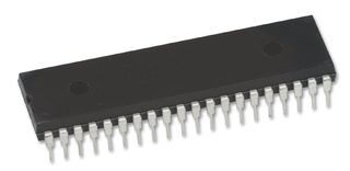

Datasheet NTE6809 - NTE Electronics IC, 8 bit MPU, 4 MHz, DIP-40
Part Number: NTE6809
Detailed Description
Manufacturer: NTE Electronics
Description: IC, 8 bit MPU, 4 MHz, DIP-40
Docket:
NTE6809 & NTE6809E Integrated Circuit NMOS, 8Bit Microprocessor (MPU)
Description: The NTE6809 and NTE6809E are revolutionary high performance 8bit microprocessors in 40Lead DIP type packages which support modern programming techniques such as position independece, reentrancy, and modular programming.
The basic instructions of any computer are greatly enhanced by the presence of powerful addressing modes. The NTE6809 and NTE6809E have the most complete set of addressing modes available on any 8bit microprocessor today. These devices contain hardware and software features which make them ideal processors for higher level language execution or standard controller applications. External clock inputs are provided on the NTE6809E to allow synchronization with peripherals, systems, or other MPUs. Architectural Features: D Two 16Bit Index Registers D Two 16Bit Indexable Stack Pointers D Two 8Bit Accumulators can be Concatenated to Form One 16Bit Accumulator D Direct Page Register Allo
Specifications:
- CPU Speed: 4 MHz
- Clock Frequency: 4 MHz
- Core Size: 8 bit
- Frequency: 4 MHz
- Number of Pins: 40
- Operating Temperature Range: 0°C to +70°C
- Package / Case: DIP
- Supply Voltage Range: 4.75 V to 5.25 V
