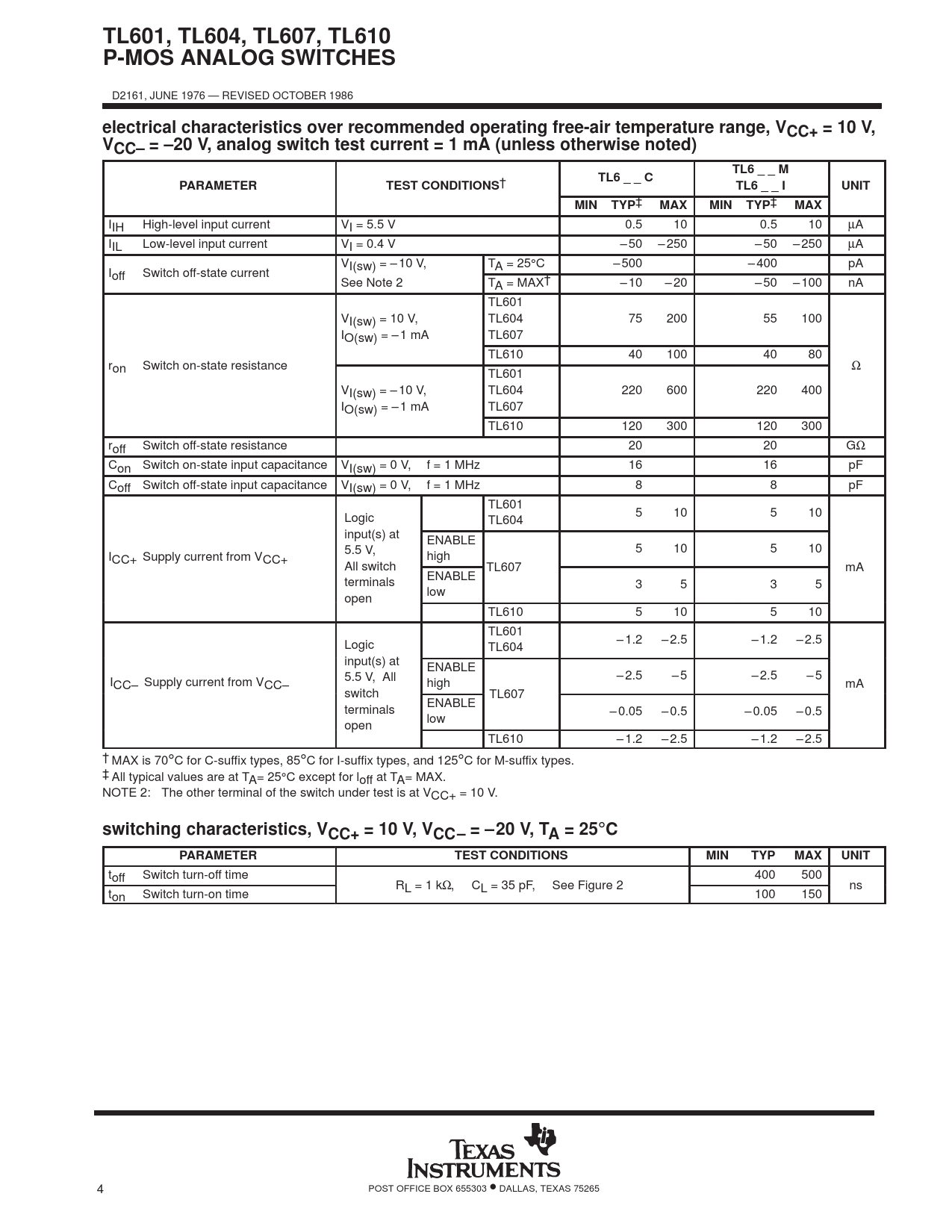

TL601, TL604, TL607, TL610 P-MOS ANALOG SWITCHES
D2161, JUNE 1976 — REVISED OCTOBER 1986
electrical characteristics over recommended operating free-air temperature range, VCC+ = 10 V, VCC– = –20 V, analog switch test current = 1 mA (unless otherwise noted) TL6 _ _ M PARAMETER TEST CONDITIONS
TL6 _ _ C TL6 _ _ I UNIT MIN TYP
MAX MIN TYP
MAX
IIH High-level input current VI = 5.5 V 0.5 10 0.5 10 µA IIL Low-level input current VI = 0.4 V – 50 – 250 – 50 – 250 µA VI(sw) = – 10 V, TA = 25°C – 500 – 400 pA Ioff Switch off-state current See Note 2 TA = MAX† – 10 – 20 – 50 – 100 nA TL601 VI(sw) = 10 V, TL604 75 200 55 100 IO(sw) = – 1 mA TL607 TL610 40 100 40 80 ron Switch on-state resistance Ω TL601 VI(sw) = – 10 V, TL604 220 600 220 400 IO(sw) = – 1 mA TL607 TL610 120 300 120 300 roff Switch off-state resistance 20 20 GΩ Con Switch on-state input capacitance VI(sw) = 0 V, f = 1 MHz 16 16 pF Coff Switch off-state input capacitance VI(sw) = 0 V, f = 1 MHz 8 8 pF TL601 Logic 5 10 5 10 TL604 input(s) at ENABLE 5.5 V, 5 10 5 10 ICC+ Supply current from VCC+ high All switch TL607 mA ENABLE terminals 3 5 3 5 low open TL610 5 10 5 10 TL601 Logic – 1.2 – 2.5 – 1.2 – 2.5 TL604 input(s) at ENABLE 5.5 V, All – 2.5 – 5 – 2.5 – 5 ICC– Supply current from VCC– high mA switch TL607 ENABLE terminals – 0.05 – 0.5 – 0.05 – 0.5 low open TL610 – 1.2 – 2.5 – 1.2 – 2.5 † MAX is 70°C for C-suffix types, 85°C for I-suffix types, and 125°C for M-suffix types. ‡ All typical values are at TA= 25°C except for loff at TA= MAX. NOTE 2: The other terminal of the switch under test is at VCC+ = 10 V.
switching characteristics, VCC+ = 10 V, VCC– = –20 V, TA = 25
C PARAMETER TEST CONDITIONS MIN TYP MAX UNIT
toff Switch turn-off time 400 500 RL = 1 kΩ, CL = 35 pF, See Figure 2 ns ton Switch turn-on time 100 150 4 POST OFFICE BOX 655303 • DALLAS, TEXAS 75265
