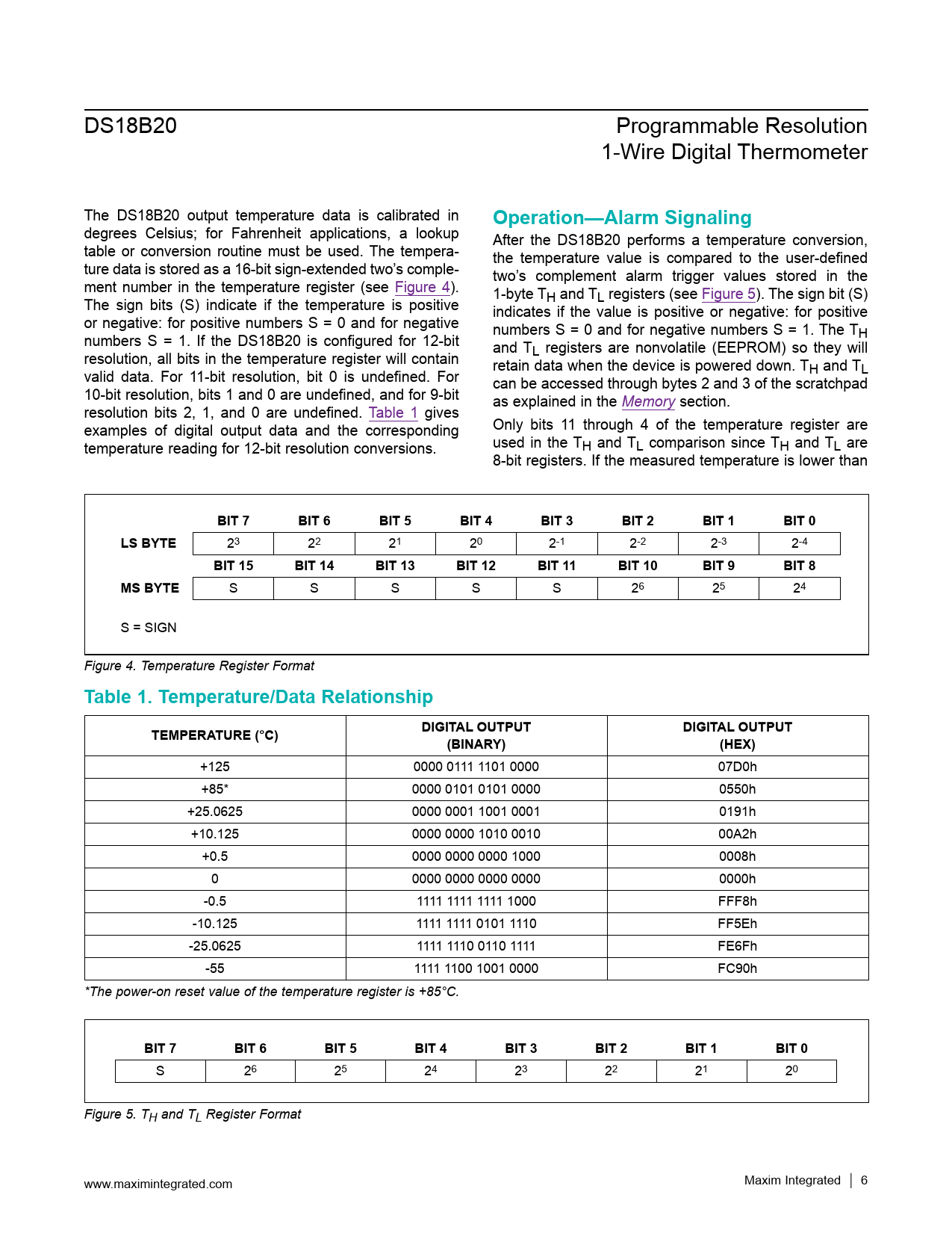

link to page 6 link to page 6 link to page 6 link to page 8 DS18B20 Programmable Resolution 1-Wire Digital Thermometer The DS18B20 output temperature data is calibrated in
Operation—Alarm Signaling
degrees Celsius; for Fahrenheit applications, a lookup After the DS18B20 performs a temperature conversion, table or conversion routine must be used. The tempera- the temperature value is compared to the user-defined ture data is stored as a 16-bit sign-extended two’s comple- two’s complement alarm trigger values stored in the ment number in the temperature register (see Figure 4). 1-byte T The sign bits (S) indicate if the temperature is positive H and TL registers (see Figure 5). The sign bit (S) indicates if the value is positive or negative: for positive or negative: for positive numbers S = 0 and for negative numbers S = 0 and for negative numbers S = 1. The T numbers S = 1. If the DS18B20 is configured for 12-bit H and T resolution, all bits in the temperature register will contain L registers are nonvolatile (EEPROM) so they will retain data when the device is powered down. T valid data. For 11-bit resolution, bit 0 is undefined. For H and TL can be accessed through bytes 2 and 3 of the scratchpad 10-bit resolution, bits 1 and 0 are undefined, and for 9-bit as explained in the Memory section. resolution bits 2, 1, and 0 are undefined. Table 1 gives examples of digital output data and the corresponding Only bits 11 through 4 of the temperature register are temperature reading for 12-bit resolution conversions. used in the TH and TL comparison since TH and TL are 8-bit registers. If the measured temperature is lower than
BIT 7 BIT 6 BIT 5 BIT 4 BIT 3 BIT 2 BIT 1 BIT 0 LS BYTE
23 22 21 20 2-1 2-2 2-3 2-4
BIT 15 BIT 14 BIT 13 BIT 12 BIT 11 BIT 10 BIT 9 BIT 8 MS BYTE
S S S S S 26 25 24 S = SIGN Figure 4. Temperature Register Format
Table 1. Temperature/Data Relationship TEMPERATURE (°C) DIGITAL OUTPUT DIGITAL OUTPUT (BINARY) (HEX)
+125 0000 0111 1101 0000 07D0h +85* 0000 0101 0101 0000 0550h +25.0625 0000 0001 1001 0001 0191h +10.125 0000 0000 1010 0010 00A2h +0.5 0000 0000 0000 1000 0008h 0 0000 0000 0000 0000 0000h -0.5 1111 1111 1111 1000 FFF8h -10.125 1111 1111 0101 1110 FF5Eh -25.0625 1111 1110 0110 1111 FE6Fh -55 1111 1100 1001 0000 FC90h *The power-on reset value of the temperature register is +85°C.
S 26 25 24 23 22 21 20 Figure 5. TH and TL Register Format www.maximintegrated.com Maxim Integrated │
