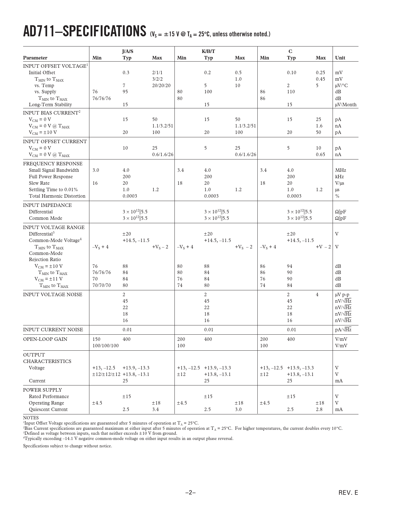

AD711–SPECIFICATIONS (VS =. V @ TA = 25. C, unless otherwise noted.). J/A/S. K/B/T. Parameter. Min. Typ. Max. Unit
AD711–SPECIFICATIONS (VS = V @ TA = 25 C, unless otherwise noted.) J/A/S K/B/T Parameter Min Typ Max Unit
AD711–SPECIFICATIONS (VS = 15 V @ TA = 25 C, unless otherwise noted.) J/A/S K/B/T C Parameter Min Typ Max Min Typ Max Min Typ Max Unit
INPUT OFFSET VOLTAGE1 Initial Offset 0.3 2/1/1 0.2 0.5 0.10 0.25 mV TMIN to TMAX 3/2/2 1.0 0.45 mV vs. Temp 7 20/20/20 5 10 2 5 mV/∞C vs. Supply 76 95 80 100 86 110 dB TMIN to TMAX 76/76/76 80 86 dB Long-Term Stability 15 15 15 mV/Month INPUT BIAS CURRENT2 VCM = 0 V 15 50 15 50 15 25 pA VCM = 0 V @ TMAX 1.1/3.2/51 1.1/3.2/51 1.6 nA VCM = ± 10 V 20 100 20 100 20 50 pA INPUT OFFSET CURRENT VCM = 0 V 10 25 5 25 5 10 pA VCM = 0 V @ TMAX 0.6/1.6/26 0.6/1.6/26 0.65 nA FREQUENCY RESPONSE Small Signal Bandwidth 3.0 4.0 3.4 4.0 3.4 4.0 MHz Full Power Response 200 200 200 kHz Slew Rate 16 20 18 20 18 20 V/ms Settling Time to 0.01% 1.0 1.2 1.0 1.2 1.0 1.2 ms Total Harmonic Distortion 0.0003 0.0003 0.0003 % INPUT IMPEDANCE Differential 3 ¥ 1012储5.5 3 ¥ 1012储5.5 3 ¥ 1012储5.5 W储pF Common Mode 3 ¥ 1012储5.5 3 ¥ 1012储5.5 3 ¥ 1012储5.5 W储pF INPUT VOLTAGE RANGE Differential3 ±20 ±20 ±20 V Common-Mode Voltage4 +14.5, –11.5 +14.5, –11.5 +14.5, –11.5 TMIN to TMAX –VS + 4 +VS – 2 –VS + 4 +VS – 2 –VS + 4 +V – 2 V Common-Mode Rejection Ratio VCM = ± 10 V 76 88 80 88 86 94 dB TMIN to TMAX 76/76/76 84 80 84 86 90 dB VCM = ± 11 V 70 84 76 84 76 90 dB TMIN to TMAX 70/70/70 80 74 80 74 84 dB INPUT VOLTAGE NOISE 2 2 2 4 mV p-p 45 45 45 nV/÷Hz 22 22 22 nV/÷Hz 18 18 18 nV/÷Hz 16 16 16 nV/÷Hz INPUT CURRENT NOISE 0.01 0.01 0.01 pA/÷Hz OPEN-LOOP GAIN 150 400 200 400 200 400 V/mV 100/100/100 100 100 V/mV OUTPUT CHARACTERISTICS Voltage +13, –12.5 +13.9, –13.3 +13, –12.5 +13.9, –13.3 +13, –12.5 +13.9, –13.3 V ±12/±12/±12 +13.8, –13.1 ±12 +13.8, –13.1 ±12 +13.8, –13.1 V Current 25 25 25 mA POWER SUPPLY Rated Performance ±15 ±15 ±15 V Operating Range ±4.5 ±18 ±4.5 ±18 ±4.5 ±18 V Quiescent Current 2.5 3.4 2.5 3.0 2.5 2.8 mA NOTES 1Input Offset Voltage specifications are guaranteed after 5 minutes of operation at T = 25∞C. A 2Bias Current specifications are guaranteed maximum at either input after 5 minutes of operation at T = 25∞C. For higher temperatures, the current doubles every 10∞C. A 3Defined as voltage between inputs, such that neither exceeds ± 10 V from ground. 4Typically exceeding –14.1 V negative common-mode voltage on either input results in an output phase reversal. Specifications subject to change without notice. –2– REV. E Document Outline FEATURES PRODUCT DESCRIPTION CONNECTION DIAGRAMS PRODUCT HIGHLIGHTS SPECIFICATIONS ABSOLUTE MAXIMUM RATINGS ORDERING GUIDE Typical Performance Characteristics OPTIMIZING SETTLING TIME OP AMP SETTLING TIME—A MATHEMATICAL MODEL GUARDING D/A CONVERTER APPLICATIONS NOISE CHARACTERISTICS DRIVING THE ANALOG INPUT OF AN A/D CONVERTER DRIVING A LARGE CAPACITIVE LOAD ACTIVE FILTER APPLICATIONS SECOND ORDER LOW PASS FILTER 9-POLE CHEBYCHEV FILTER OUTLINE DIMENSIONS Revision History
