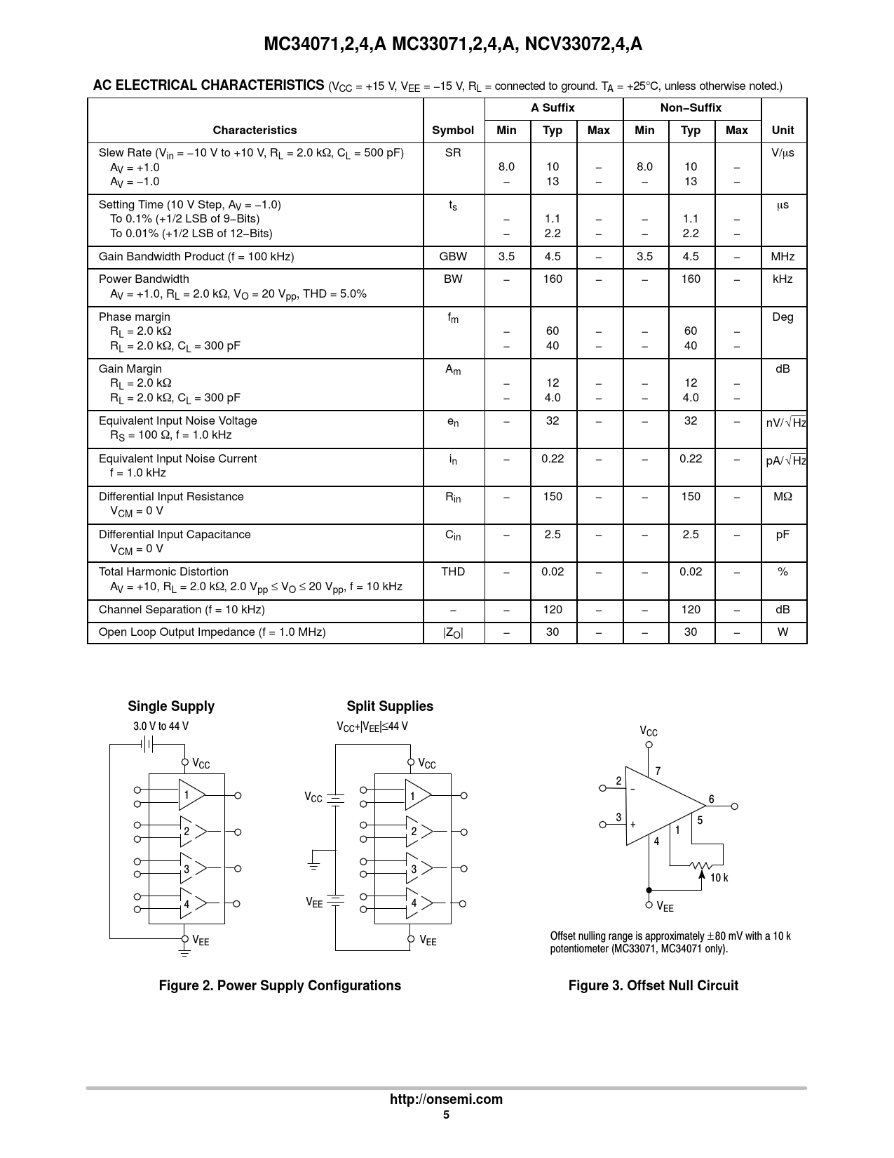

MC34071,2,4,A MC33071,2,4,A, NCV33072,4,A. AC ELECTRICAL CHARACTERISTICS. A Suffix. Non−Suffix. Characteristics. Symbol. Min. Typ. Max
MC34071,2,4,A MC33071,2,4,A, NCV33072,4,A AC ELECTRICAL CHARACTERISTICS A Suffix Non−Suffix Characteristics Symbol Min Typ Max
(VCC = +15 V, VEE = −15 V, RL = connected to ground. TA = +25°C, unless otherwise noted.)
A Suffix Non−Suffix Characteristics Symbol Min Typ Max Min Typ Max Unit
Slew Rate (Vin = −10 V to +10 V, RL = 2.0 kW, CL = 500 pF) SR V/ms AV = +1.0 8.0 10 − 8.0 10 − AV = −1.0 − 13 − − 13 − Setting Time (10 V Step, AV = −1.0) ts ms To 0.1% (+1/2 LSB of 9−Bits) − 1.1 − − 1.1 − To 0.01% (+1/2 LSB of 12−Bits) − 2.2 − − 2.2 − Gain Bandwidth Product (f = 100 kHz) GBW 3.5 4.5 − 3.5 4.5 − MHz Power Bandwidth BW − 160 − − 160 − kHz AV = +1.0, RL = 2.0 kW, VO = 20 Vpp, THD = 5.0% Phase margin fm Deg RL = 2.0 kW − 60 − − 60 − RL = 2.0 kW, CL = 300 pF − 40 − − 40 − Gain Margin Am dB RL = 2.0 kW − 12 − − 12 − RL = 2.0 kW, CL = 300 pF − 4.0 − − 4.0 − Equivalent Input Noise Voltage en − 32 − − 32 − nV/ √ Hz RS = 100 W, f = 1.0 kHz Equivalent Input Noise Current in − 0.22 − − 0.22 − pA/ √ Hz f = 1.0 kHz Differential Input Resistance Rin − 150 − − 150 − MW VCM = 0 V Differential Input Capacitance Cin − 2.5 − − 2.5 − pF VCM = 0 V Total Harmonic Distortion THD − 0.02 − − 0.02 − % AV = +10, RL = 2.0 kW, 2.0 Vpp ≤ VO ≤ 20 Vpp, f = 10 kHz Channel Separation (f = 10 kHz) − − 120 − − 120 − dB Open Loop Output Impedance (f = 1.0 MHz) |ZO| − 30 − − 30 − W
Single Supply Split Supplies
3.0 V to 44 V VCC+|VEE|≤44 V VCC VCC VCC 7 2 - 1 VCC 1 6 3 5 + 2 2 1 4 3 3 10 k 4 VEE 4 VEE V Offset nulling range is approximately ± 80 mV with a 10 k EE VEE potentiometer (MC33071, MC34071 only).
Figure 2. Power Supply Configurations Figure 3. Offset Null Circuit http://onsemi.com 5
