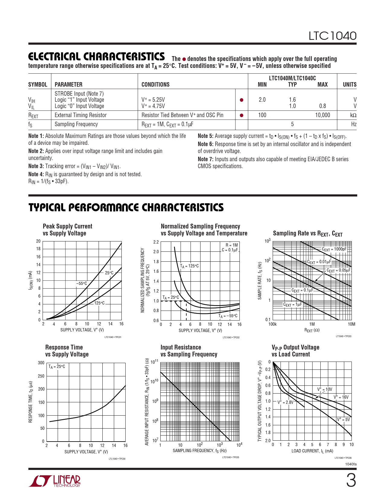

ELECTRICAL CHARACTERISTICS The. denotes the specifications which apply over the full operating
LTC1040
denotes the specifications which apply over the full operating temperature range otherwise specifications are at TA = 25
C. Test conditions: V+ = 5V, V – = – 5V, unless otherwise specified LTC1040M/LTC1040C SYMBOL PARAMETER CONDITIONS MIN TYP MAX UNITS
STROBE Input (Note 7) VIH Logic “1” Input Voltage V+ = 5.25V ● 2.0 1.6 V VIL Logic “0” Input Voltage V+ = 4.75V 1.0 0.8 V REXT External Timing Resistor Resistor Tied Between V+ and OSC Pin ● 100 10,000 kΩ fS Sampling Frequency REXT = 1M, CEXT = 0.1µF 5 Hz
Note 1:
Absolute Maximum Ratings are those values beyond which the life
Note 5:
Average supply current = tD • lS(ON) • fS + (1 – tD x fS) • lS(OFF). of a device may be impaired.
Note 6:
Response time is set by an internal oscillator and is independent
Note 2:
Applies over input voltage range limit and includes gain of overdrive voltage. uncertainty.
Note 7:
Inputs and outputs also capable of meeting EIA/JEDEC B series
Note 3:
Tracking error = (VIN1 – VIN2)/ VIN1. CMOS specifications.
Note 4:
RIN is guaranteed by design and is not tested. RIN = 1/(fS • 33pF).
W U TYPICAL PERFOR A CE CHARACTERISTICS Peak Supply Current Normalized Sampling Frequency vs Supply Voltage vs Supply Voltage and Temperature Sampling Rate vs REXT, CEXT
20 2.2 103 R = 1M 18 C 2.0 C = 0.1µF EXT = 1000pF 16 1.8 102 CEXT = 0.01µF 14 °C) TA = 125°C (Hz) C 12 S 25°C 1.6 EXT = 0.05µF (mA) 10 1.4 10 –55°C AT 5V, 25 I S(ON) 8 S/f C S 1.2 EXT = 0.1µF 6 (f TA = 25°C SAMPLE RATE, f 1.0 1 4 125°C CEXT = 1µF 2 NORMALIZED SAMPLING FREQUENCY 0.8 TA = –55°C 0 0.6 0.1 2 4 6 8 10 12 14 16 0 2 4 6 8 10 12 14 16 100k 1M 10M SUPPLY VOLTAGE, V+ (V) SUPPLY VOLTAGE, V+ (V) REXT (Ω) LTC1040 • TPC01 LT1040 • TPC03 LTC1040 • TPC02
Response Time Input Resistance VP-P Output Voltage vs Supply Voltage vs Sampling Frequency vs Load Current
