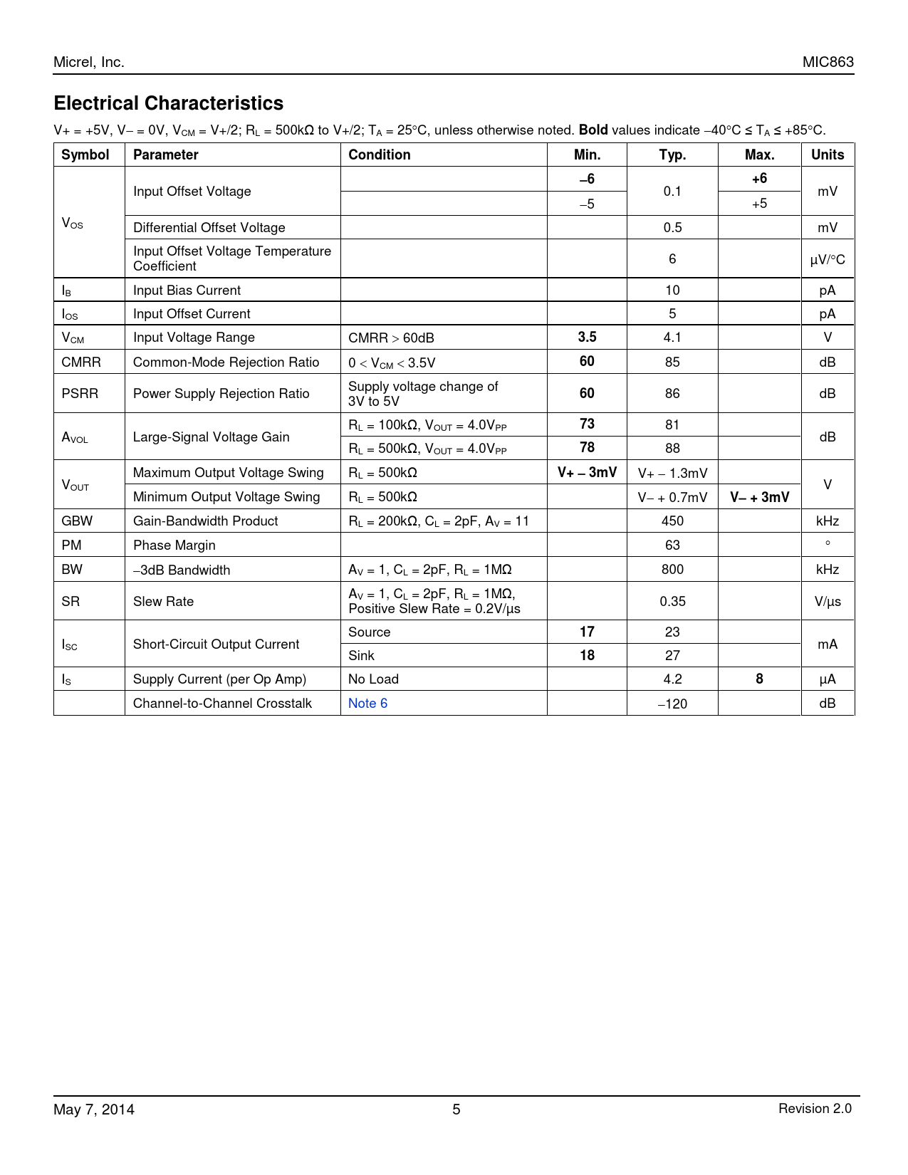

Micrel, Inc. MIC863 Electrical Characteristics
Micrel, Inc MIC863 Electrical Characteristics
V+ = +5V, V− = 0V, VCM = V+/2; RL = 500kΩ to V+/2; TA = 25°C, unless otherwise noted. Bold values indicate −40°C ≤ TA ≤ +85°C.
Symbol Parameter Condition Min.
−6 Input Offset Voltage
VOS −5 Differential Offset Voltage Typ. Max. Units +6
0.1 mV +5 0.5 mV Input Offset Voltage Temperature
Coefficient 6 µV/°C IB Input Bias Current 10 pA IOS Input Offset Current 5 pA VCM Input Voltage Range CMRR > 60dB 3.5 4.1 V CMRR Common-Mode Rejection Ratio 0 < VCM < 3.5V 60 85 dB PSRR Power Supply Rejection Ratio Supply voltage change of
3V to 5V 60 86 dB AVOL Large-Signal Voltage Gain RL = 100kΩ, VOUT = 4.0VPP 73 81 RL = 500kΩ, VOUT = 4.0VPP 78 88 V+ − 3mV V+ − 1.3mV Maximum Output Voltage Swing RL = 500kΩ Minimum Output Voltage Swing RL = 500kΩ GBW Gain-Bandwidth Product RL = 200kΩ, CL = 2pF, AV = 11 PM Phase Margin BW −3dB Bandwidth SR Slew Rate ISC Short-Circuit Output Current IS Supply Current (per Op Amp) No Load Channel-to-Channel Crosstalk Note 6 VOUT May 7, 2014 V− + 0.7mV dB V
V− + 3mV 450 kHz 63 ° AV = 1, CL = 2pF, RL = 1MΩ 800 kHz AV = 1, CL = 2pF, RL = 1MΩ,
Positive Slew Rate = 0.2V/µs 0.35 V/µs Source 17 23 Sink 18 27
4.2
−120 5 mA
8 µA
dB Revision 2.0
