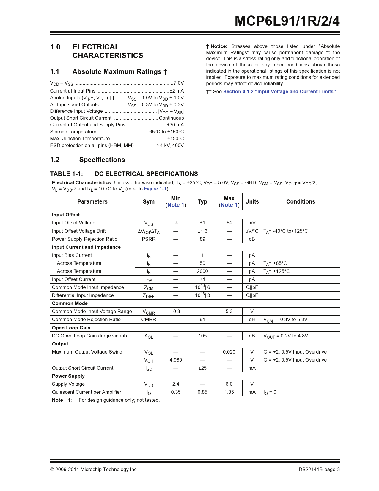

MCP6L91/1R/2/4. 1.0. ELECTRICAL. † Notice:. CHARACTERISTICS. 1.1. Absolute Maximum Ratings †
MCP6L91/1R/2/4 1.0 ELECTRICAL † Notice: CHARACTERISTICS 1.1 Absolute Maximum Ratings †
link to page 11 link to page 4 link to page 3 link to page 3
Stresses above those listed under “Absolute
CHARACTERISTICS
Maximum Ratings” may cause permanent damage to the device. This is a stress rating only and functional operation of the device at those or any other conditions above those
indicated in the operational listings of this specification is not implied. Exposure to maximum rating conditions for extended VDD – VSS ...7.0V periods may affect device reliability. Current at Input Pins ..±2 mA †† See
Section 4.1.2 “Input Voltage and Current Limits”
. Analog Inputs (VIN+, VIN–) †† ... VSS – 1.0V to VDD + 1.0V All Inputs and Outputs ... VSS – 0.3V to VDD + 0.3V Difference Input Voltage .. |VDD – VSS| Output Short Circuit Current .. Continuous Current at Output and Supply Pins ..±30 mA Storage Temperature ...-65°C to +150°C Max. Junction Temperature .. +150°C ESD protection on all pins (HBM, MM)  4 kV, 400V
1.2 Specifications TABLE 1-1: DC ELECTRICAL SPECIFICATIONS Electrical Characteristics:
Unless otherwise indicated, TA = +25°C, VDD = 5.0V, VSS = GND, VCM = VSS, VOUT  VDD/2, VL = VDD/2 and RL = 10 k to VL (refer to Figure 1-1).
Min Max Parameters Sym Typ Units Conditions
Note 1
Note 1
Input Offset
Input Offset Voltage VOS -4 ±1 +4 mV Input Offset Voltage Drift VOS/TA — ±1.3 — µV/°C TA= -40°C to+125°C Power Supply Rejection Ratio PSRR — 89 — dB
Input Current and Impedance
Input Bias Current IB — 1 — pA Across Temperature IB — 50 — pA TA= +85°C Across Temperature IB — 2000 — pA TA= +125°C Input Offset Current IOS — ±1 — pA Common Mode Input Impedance ZCM — 1013||6 — ||pF Differential Input Impedance ZDIFF — 1013||3 — ||pF
Common Mode
Common Mode Input Voltage Range VCMR -0.3 — 5.3 V Common Mode Rejection Ratio CMRR — 91 — dB VCM = -0.3V to 5.3V
Open Loop Gain
DC Open Loop Gain (large signal) AOL — 105 — dB VOUT = 0.2V to 4.8V
Output
Maximum Output Voltage Swing VOL — — 0.020 V G = +2, 0.5V Input Overdrive VOH 4.980 — — V G = +2, 0.5V Input Overdrive Output Short Circuit Current ISC — ±25 — mA
Power Supply
Supply Voltage VDD 2.4 — 6.0 V Quiescent Current per Amplifier IQ 0.35 0.85 1.35 mA IO = 0
Note 1:
