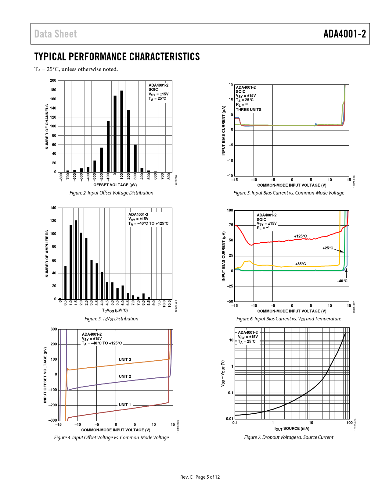

Data Sheet. ADA4001-2. TYPICAL PERFORMANCE CHARACTERISTICS. 200. 15 ADA4001-2. 180. SOIC. VSY = ±15V. 160. TA = 25°C. 10 TA = 25°C. RL = ∞
Data Sheet ADA4001-2 TYPICAL PERFORMANCE CHARACTERISTICS
TA = 25°C, unless otherwise noted.
200 ADA4001-2 15 ADA4001-2 180 SOIC SOIC VSY = ±15V VSY = ±15V 160 TA = 25°C 10 TA = 25°C S RL = ∞ L 140 A) p THREE UNITS ( 5 120 NT CHANNE 100 F 0 R O CURRE 80 BE AS BI 60 –5 NUM UT 40 INP –10 20 0 0 –15 100 200 300 400 500 600 700 800

10375- Figure 2. Input Offset Voltage Distribution Figure 5. Input Bias Current vs. Common-Mode Voltage
140 100 ADA4001-2 ADA4001-2 120 VSY = ±15V SOIC TA = –40°C TO +125°C 75 VSY = ±15V RL = ∞ RS 100 A) IE p +125°C ( IF 50 L NT P 80 +25°C AM F 25 CURRE 60 R O AS +85°C BE BI 0 40 UT NUM INP –40°C 20 –25 0 0 5 0 5 0 5 0 5 0 5 0 5 0 5 0 5 0 5 0 5 0 5 –50 0. 1. 1. 2. 2. 3. 3. 4. 4. 5. 5. 6. 6. 7. 7. 8. 8. 9. 9.

10375- Figure 3. TCVOS Distribution Figure 6. Input Bias Current vs. VCM and Temperature
300 ADA4001-2 ADA4001-2 V V SY = ±15V SY = ±15V 10 T 200 T A = 25°C A = –40°C TO +125°C ) V µ ( GE 100 UNIT 3 (V) 1 OLTA UT O 0 T V UNIT 2 E – V DDV –100 T OFFS 0.1 U P IN –200 UNIT 1 –300 0.01

10375- 10375- Figure 4. Input Offset Voltage vs. Common-Mode Voltage Figure 7. Dropout Voltage vs. Source Current Rev. C | Page 5 of 12 Document Outline Features Applications Pin Configuration General Description Revision History Specifications Electrical Characteristics Absolute Maximum Ratings Thermal Resistance ESD Caution Typical Performance Characteristics Applications Information Total Noise Including Source Resistors I-V Conversion Applications Photodiode Circuits Input Bias Current Noise Considerations Outline Dimensions Ordering Guide
