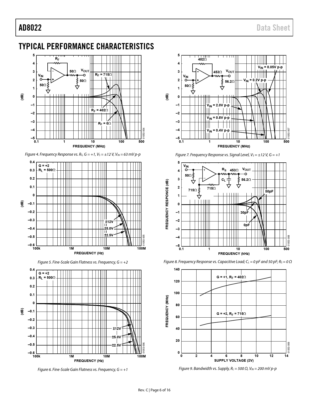

AD8022. Data Sheet. TYPICAL PERFORMANCE CHARACTERISTICS. 402. VIN = 0.05V p-p. VOUT. 453. F = 715. VIN. 56.2. VIN = 0.2V p-p. (dB)

Figure 4. Frequency Response vs. RF, G = +1, VS = ±12 V, VIN = 63 mV p-p Figure 7. Frequency Response vs. Signal Level, VS = ±12 V, G = +1

Figure 5. Fine-Scale Gain Flatness vs. Frequency, G = +2 Figure 8. Frequency Response vs. Capacitive Load; CL = 0 pF and 50 pF; RS = 0 Ω

Figure 6. Fine-Scale Gain Flatness vs. Frequency, G = +1 Figure 9. Bandwidth vs. Supply, RL = 500 Ω, VIN = 200 mV p-p Rev. C | Page 6 of 16 Document Outline FEATURES APPLICATIONS FUNCTIONAL BLOCK DIAGRAM GENERAL DESCRIPTIONS REVISION HISTORY SPECIFICATIONS ABSOLUTE MAXIMUM RATINGS MAXIMUM POWER DISSIPATION ESD CAUTION TYPICAL PERFORMANCE CHARACTERISTICS THEORY OF OPERATION APPLICATIONS DMT MODULATION AND MULTITONE POWER RATIO (MTPR) CHANNEL CAPACITY AND SNR POWER SUPPLY AND DECOUPLING LAYOUT CONSIDERATIONS OUTLINE DIMENSIONS ORDERING GUIDE
