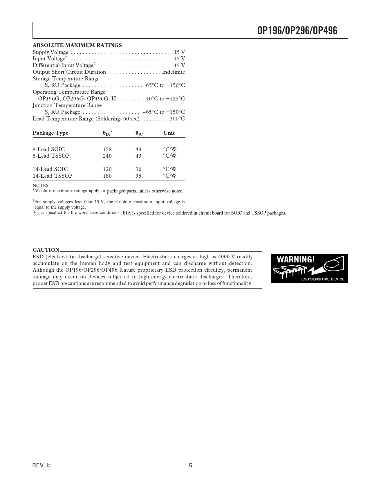

OP196/OP296/OP496 ABSOLUTE MAXIMUM RATINGS1
Supply Voltage . 15 V Input Voltage2 . 15 V Differential Input Voltage2 . 15 V Output Short Circuit Duration . Indefinite Storage Temperature Range S, RU Package . –65°C to +150°C Operating Temperature Range OP196G, OP296G, OP496G, H . – 40°C to +125°C Junction Temperature Range S, RU Package . – 65°C to +150°C Lead Temperature Range (Soldering, 60 sec) . 300°C
Package Type
3 JA
JC Unit
8-Lead SOIC 158 43 °C/W 8-Lead TSSOP 240 43 °C/W 14-Lead SOIC 120 36 °C/W 14-Lead TSSOP 180 35 °C/W NOTES 1Absolute maximum ratings apply to packaged parts, unless otherwise noted. 2For supply voltages less than 15 V, the absolute maximum input voltage is equal to the supply voltage. 3θJA is specified for the worst case conditions ; θJ A is specified for device soldered in circuit board for SOIC and TSSOP packages.
CAUTION
ESD (electrostatic discharge) sensitive device. Electrostatic charges as high as 4000 V readily
WARNING!
accumulate on the human body and test equipment and can discharge without detection. Although the OP196/OP296/OP496 feature proprietary ESD protection circuitry, permanent damage may occur on devices subjected to high-energy electrostatic discharges. Therefore,
ESD SENSITIVE DEVICE
proper ESD precautions are recommended to avoid performance degradation or loss of functionalit y. REV. E –5– Document Outline FEATURES APPLICATIONS PIN CONFIGURATIONS GENERAL DESCRIPTION OP196/OP296/OP496--SPECIFICATIONS Electrical Specifications (@Vs = 5.0 V) Electrical Specifications (@Vs = 3.0 V) Electrical Specifications (@Vs = 12.0 V) ABSOLUTE MAXIMUM RATINGS ESD Caution TYPICAL PERFORMANCE CHARACTERISTICS APPLICATIONS INFORMATION Functional Description Input Overvoltage Protection Output Phase Reversal Input Offset Voltage Nulling Driving Capacitive Loads A Micropower False-Ground Generator Single-Supply Half-Wave and Full-Wave Rectifiers Square Wave Oscillator A 3 V Low Dropout, Linear Voltage Regulator Buffering a DAC Output A High-Side Current Monitor A Single-Supply RTD Amplifier OUTLINE DIMENSIONS Ordering Guide REVISION HISTORY
