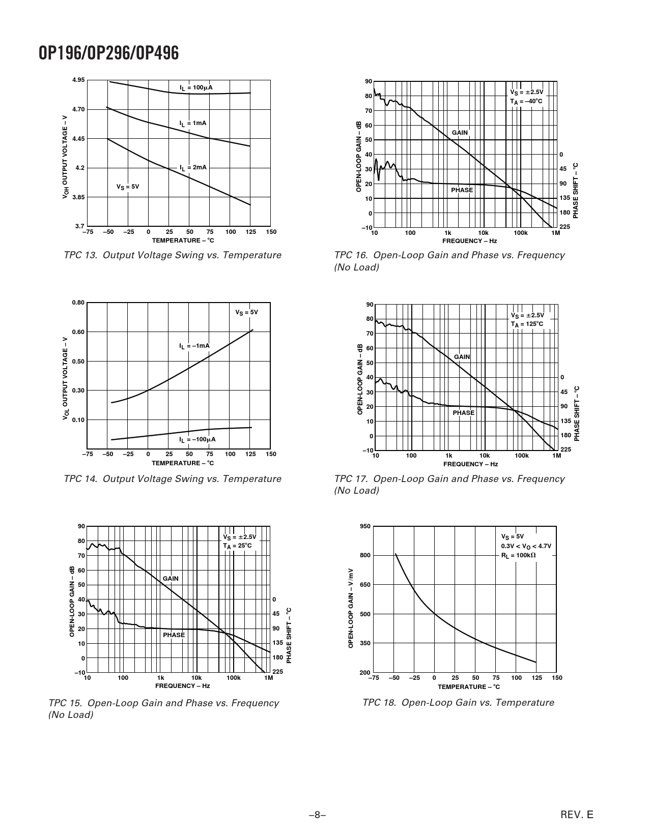

Pages / Page19 / 8 — OP196/OP296/OP496. 4.95. IL = 100. S =. 2.5V. TA = –40. 4.70. V –. IL = …

OP196/OP296/OP496. 4.95. IL = 100. S =. 2.5V. TA = –40. 4.70. V –. IL = 1mA. dB –. GAIN. 4.45. 4.2. IL = 2mA. C –. OUTPUT VOLTAGE. VS = 5V
OP196/OP296/OP496 4.95 IL = 100 S = 2.5V TA = –40 4.70 V – IL = 1mA dB – GAIN 4.45 4.2 IL = 2mA C – OUTPUT VOLTAGE VS = 5V

TPC 13. Output Voltage Swing vs. Temperature TPC 16. Open-Loop Gain and Phase vs. Frequency (No Load)

TPC 14. Output Voltage Swing vs. Temperature TPC 17. Open-Loop Gain and Phase vs. Frequency (No Load)

TPC 15. Open-Loop Gain and Phase vs. Frequency TPC 18. Open-Loop Gain vs. Temperature (No Load) –8– REV. E Document Outline FEATURES APPLICATIONS PIN CONFIGURATIONS GENERAL DESCRIPTION OP196/OP296/OP496--SPECIFICATIONS Electrical Specifications (@Vs = 5.0 V) Electrical Specifications (@Vs = 3.0 V) Electrical Specifications (@Vs = 12.0 V) ABSOLUTE MAXIMUM RATINGS ESD Caution TYPICAL PERFORMANCE CHARACTERISTICS APPLICATIONS INFORMATION Functional Description Input Overvoltage Protection Output Phase Reversal Input Offset Voltage Nulling Driving Capacitive Loads A Micropower False-Ground Generator Single-Supply Half-Wave and Full-Wave Rectifiers Square Wave Oscillator A 3 V Low Dropout, Linear Voltage Regulator Buffering a DAC Output A High-Side Current Monitor A Single-Supply RTD Amplifier OUTLINE DIMENSIONS Ordering Guide REVISION HISTORY
