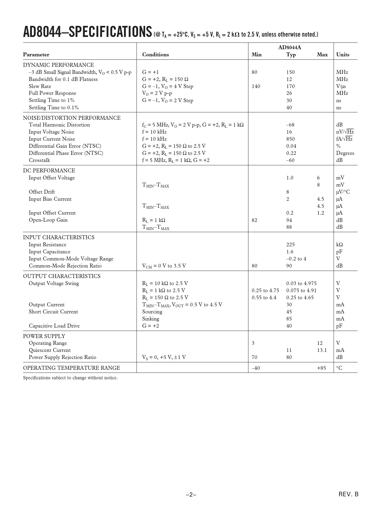

AD8044–SPECIFICATIONS(@ TA = +25. C, VS = +5 V, RL = 2 k. to 2.5 V, unless otherwise noted.). AD8044A. Parameter. Conditions. Min
AD8044–SPECIFICATIONS(@ TA = +25 C, VS = +5 V, RL = 2 k to 2.5 V, unless otherwise noted.) AD8044A Parameter Conditions Min
to 2.5 V, unless otherwise noted.) AD8044A Parameter Conditions Min Typ Max Units
DYNAMIC PERFORMANCE –3 dB Small Signal Bandwidth, VO < 0.5 V p-p G = +1 80 150 MHz Bandwidth for 0.1 dB Flatness G = +2, RL = 150 W 12 MHz Slew Rate G = –1, VO = 4 V Step 140 170 V/ms Full Power Response VO = 2 V p-p 26 MHz Settling Time to 1% G = –1, VO = 2 V Step 30 ns Settling Time to 0.1% 40 ns NOISE/DISTORTION PERFORMANCE Total Harmonic Distortion fC = 5 MHz, VO = 2 V p-p, G = +2, RL = 1 kW –68 dB Input Voltage Noise f = 10 kHz 16 nV/÷Hz Input Current Noise f = 10 kHz 850 fA/÷Hz Differential Gain Error (NTSC) G = +2, RL = 150 W to 2.5 V 0.04 % Differential Phase Error (NTSC) G = +2, RL = 150 W to 2.5 V 0.22 Degrees Crosstalk f = 5 MHz, RL = 1 kW, G = +2 –60 dB DC PERFORMANCE Input Offset Voltage 1.0 6 mV TMIN–TMAX 8 mV Offset Drift 8 mV/∞C Input Bias Current 2 4.5 mA TMIN–TMAX 4.5 mA Input Offset Current 0.2 1.2 mA Open-Loop Gain RL = 1 kW 82 94 dB TMIN–TMAX 88 dB INPUT CHARACTERISTICS Input Resistance 225 kW Input Capacitance 1.6 pF Input Common-Mode Voltage Range –0.2 to 4 V Common-Mode Rejection Ratio VCM = 0 V to 3.5 V 80 90 dB OUTPUT CHARACTERISTICS Output Voltage Swing RL = 10 kW to 2.5 V 0.03 to 4.975 V Output Voltage Swing: RL = 1 kW to 2.5 V 0.25 to 4.75 0.075 to 4.91 V Output Voltage Swing: RL = 150 W to 2.5 V 0.55 to 4.4 0.25 to 4.65 V Output Current TMIN–TMAX, VOUT = 0.5 V to 4.5 V 30 mA Short Circuit Current Sourcing 45 mA Sinking 85 mA Capacitive Load Drive G = +2 40 pF POWER SUPPLY Operating Range 3 12 V Quiescent Current 11 13.1 mA Power Supply Rejection Ratio VS = 0, +5 V, ± 1 V 70 80 dB OPERATING TEMPERATURE RANGE –40 +85 ∞C Specifications subject to change without notice. –2– REV. B Document Outline FEATURES APPLICATIONS PRODUCT DESCRIPTION CONNECTION DIAGRAM SPECIFICATIONS ABSOLUTE MAXIMUM RATINGS MAXIMUM POWER DISSIPATION ORDERING GUIDE Typical Performance Characteristics Overdrive Recovery Circuit Description Driving Capacitance Loads APPLICATIONS RGB Buffer Active Filters Layout Considerations OUTLINE DIMENSIONS Revision History
