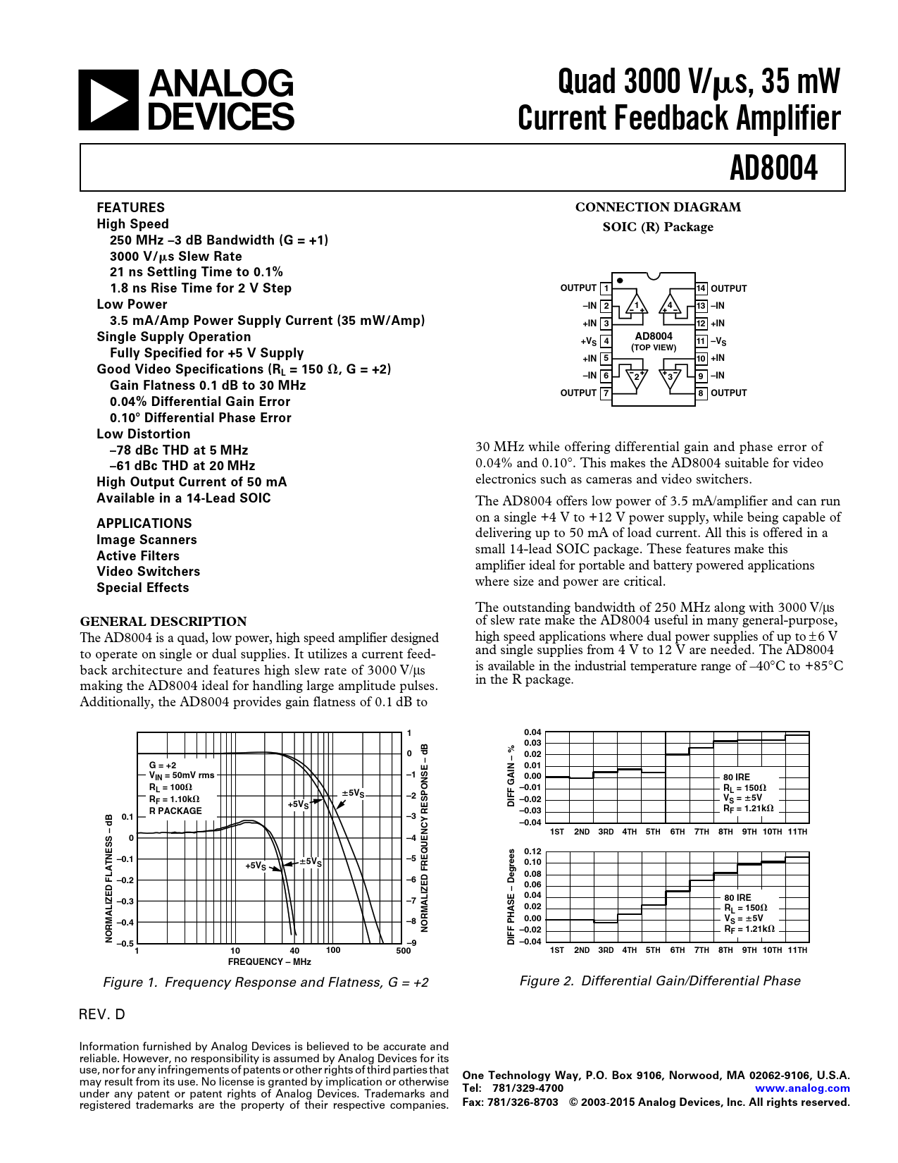

Quad 3000 V/. s, 35 mW. Current Feedback Amplifier. AD8004. FEATURES. CONNECTION DIAGRAM. High Speed. SOIC (R) Package
Datasheet AD8004 Analog Devices, Revision: D
a
Quad 3000 V/ s, 35 mW Current Feedback Amplifier AD8004 FEATURES CONNECTION DIAGRAM High Speed SOIC (R) Package 250 MHz –3 dB Bandwidth (G = +1) 3000 V/ s Slew Rate 21 ns Settling Time to 0.1% 1.8 ns Rise Time for 2 V Step OUTPUT 1 14 OUTPUT Low Power –IN 2 1 4 13 –IN 3.5 mA/Amp Power Supply Current (35 mW/Amp) +IN 3 12 +IN Single Supply Operation AD8004 +V 4 11 S –V ( S Fully Specified for +5 V Supply TOP VIEW) +IN 5 10 +IN Good Video Specifications (RL = 150 , G = +2) –IN 6 2 3 9 –IN Gain Flatness 0.1 dB to 30 MHz OUTPUT 7 8 OUTPUT 0.04% Differential Gain Error 0.10 Differential Phase Error Low Distortion –78 dBc THD at 5 MHz
30 MHz while offering differential gain and phase error of
–61 dBc THD at 20 MHz
0.04% and 0.10∞. This makes the AD8004 suitable for video
High Output Current of 50 mA
electronics such as cameras and video switchers.
Available in a 14-Lead SOIC
The AD8004 offers low power of 3.5 mA/amplifier and can run on a single +4 V to +12 V power supply, while being capable of
APPLICATIONS
delivering up to 50 mA of load current. All this is offered in a
Image Scanners
small 14-lead SOIC package. These features make this
Active Filters
amplifier ideal for portable and battery powered applications
Video Switchers
where size and power are critical.
Special Effects
The outstanding bandwidth of 250 MHz along with 3000 V/ms
GENERAL DESCRIPTION
of slew rate make the AD8004 useful in many general-purpose, The AD8004 is a quad, low power, high speed amplifier designed high speed applications where dual power supplies of up to ±6 V to operate on single or dual supplies. It utilizes a current feed- and single supplies from 4 V to 12 V are needed. The AD8004 back architecture and features high slew rate of 3000 V/ms is available in the industrial temperature range of –40∞C to +85∞C in the R package. making the AD8004 ideal for handling large amplitude pulses. Additionally, the AD8004 provides gain flatness of 0.1 dB to
1 0.04 0.03 0 0.02 G = +2 0.01 V –1 IN = 50mV rms 0.00 80 IRE RL = 100 –0.01 R 5V L = 150 S –2 R V F = 1.10k –0.02 +5V S = 5V S DIFF GAIN – % R PACKAGE –0.03 RF = 1.21k 0.1 –3 –0.04 1ST 2ND 3RD 4TH 5TH 6TH 7TH 8TH 9TH 10TH 11TH 0 –4 0.12 –0.1 –5 +5V 5VS 0.10 S 0.08 –0.2 –6 0.06 0.04 –0.3 –7 80 IRE 0.02 RL = 150 V –0.4 –8 0.00 S = 5V NORMALIZED FREQUENCY RESPONSE – dB –0.02 RF = 1.21k NORMALIZED FLATNESS – dB –0.5 –9 DIFF PHASE – Degrees –0.04 1 10 40 100 500 1ST 2ND 3RD 4TH 5TH 6TH 7TH 8TH 9TH 10TH 11TH FREQUENCY – MHz
Figure 1. Frequency Response and Flatness, G = +2 Figure 2. Differential Gain/Differential Phase REV. D Information furnished by Analog Devices is believed to be accurate and reliable. However, no responsibility is assumed by Analog Devices for its use, nor for any infringements of patents or other rights of third parties that
