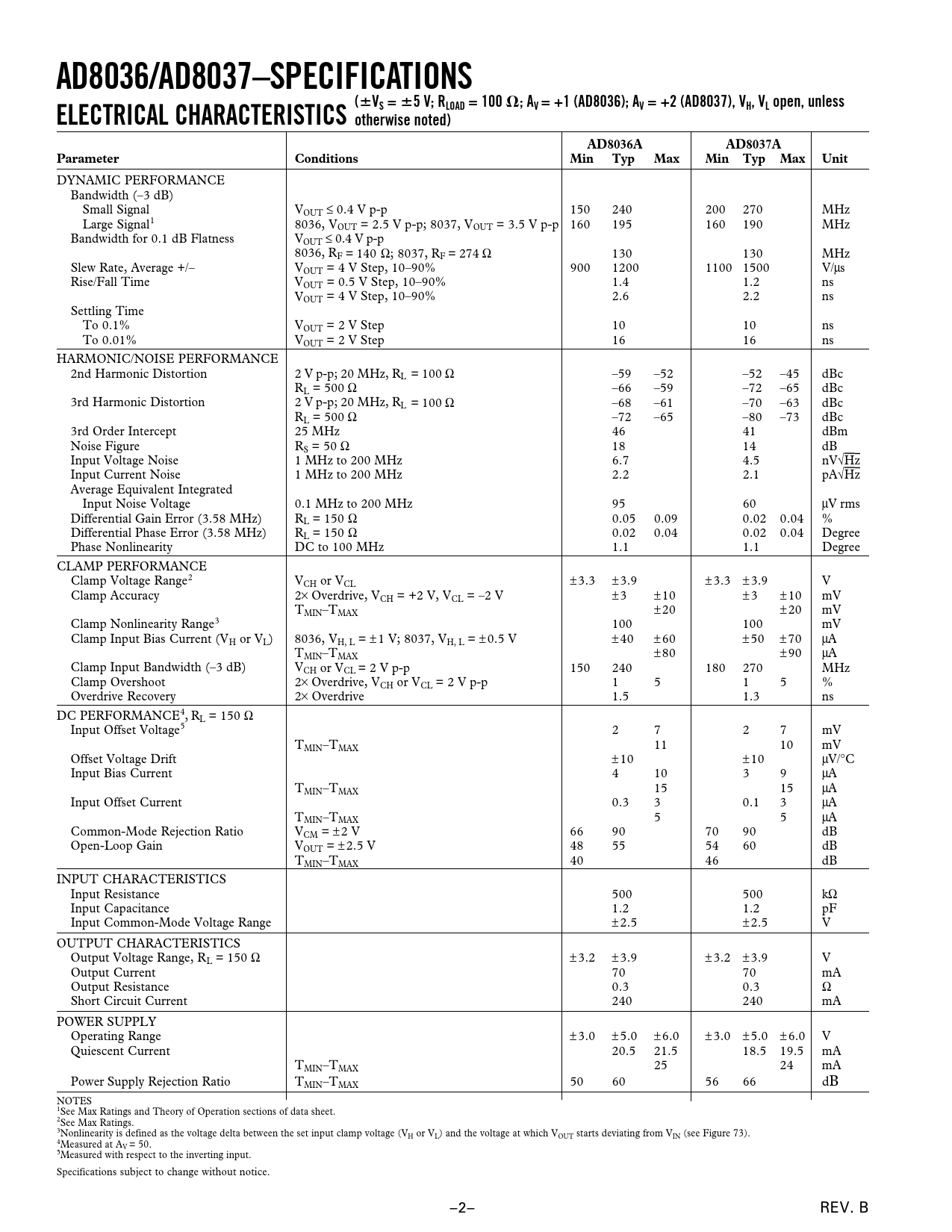

AD8036/AD8037–SPECIFICATIONS. ELECTRICAL CHARACTERISTICS. S =. 5 V; RLOAD = 100
AD8036/AD8037–SPECIFICATIONS ELECTRICAL CHARACTERISTICS S = 5 V; RLOAD = 100
AD8036/AD8037–SPECIFICATIONS ( V ELECTRICAL CHARACTERISTICS S = 5 V; RLOAD = 100 ; AV = +1 (AD8036); AV = +2 (AD8037), VH, VL open, unless otherwise noted) AD8036A AD8037A Parameter Conditions Min Typ Max Min Typ Max Unit
DYNAMIC PERFORMANCE Bandwidth (–3 dB) Small Signal VOUT ≤ 0.4 V p-p 150 240 200 270 MHz Large Signal1 8036, VOUT = 2.5 V p-p; 8037, VOUT = 3.5 V p-p 160 195 160 190 MHz Bandwidth for 0.1 dB Flatness VOUT ≤ 0.4 V p-p 8036, RF = 140 Ω; 8037, RF = 274 Ω 130 130 MHz Slew Rate, Average +/– VOUT = 4 V Step, 10–90% 900 1200 1100 1500 V/µs Rise/Fall Time VOUT = 0.5 V Step, 10–90% 1.4 1.2 ns VOUT = 4 V Step, 10–90% 2.6 2.2 ns Settling Time To 0.1% VOUT = 2 V Step 10 10 ns To 0.01% VOUT = 2 V Step 16 16 ns HARMONIC/NOISE PERFORMANCE 2nd Harmonic Distortion 2 V p-p; 20 MHz, RL = 100 Ω –59 –52 –52 –45 dBc RL = 500 Ω –66 –59 –72 –65 dBc 3rd Harmonic Distortion 2 V p-p; 20 MHz, RL = 100 Ω –68 –61 –70 –63 dBc RL = 500 Ω –72 –65 –80 –73 dBc 3rd Order Intercept 25 MHz 46 41 dBm Noise Figure RS = 50 Ω 18 14 dB Input Voltage Noise 1 MHz to 200 MHz 6.7 4.5 nV√Hz Input Current Noise 1 MHz to 200 MHz 2.2 2.1 pA√Hz Average Equivalent Integrated Input Noise Voltage 0.1 MHz to 200 MHz 95 60 µV rms Differential Gain Error (3.58 MHz) RL = 150 Ω 0.05 0.09 0.02 0.04 % Differential Phase Error (3.58 MHz) RL = 150 Ω 0.02 0.04 0.02 0.04 Degree Phase Nonlinearity DC to 100 MHz 1.1 1.1 Degree CLAMP PERFORMANCE Clamp Voltage Range2 VCH or VCL ±3.3 ±3.9 ±3.3 ±3.9 V Clamp Accuracy 2× Overdrive, VCH = +2 V, VCL = –2 V ±3 ±10 ±3 ±10 mV TMIN–TMAX ±20 ±20 mV Clamp Nonlinearity Range3 100 100 mV Clamp Input Bias Current (VH or VL) 8036, VH, L = ± 1 V; 8037, VH, L = ± 0.5 V ±40 ±60 ±50 ±70 µA T ± MIN–TMAX 80 ±90 µA Clamp Input Bandwidth (–3 dB) VCH or VCL = 2 V p-p 150 240 180 270 MHz Clamp Overshoot 2× Overdrive, VCH or VCL = 2 V p-p 1 5 1 5 % Overdrive Recovery 2× Overdrive 1.5 1.3 ns DC PERFORMANCE4, RL = 150 Ω Input Offset Voltage5 2 7 2 7 mV TMIN–TMAX 11 10 mV Offset Voltage Drift ±10 ±10 µV/°C Input Bias Current 4 10 3 9 µA TMIN–TMAX 15 15 µA Input Offset Current 0.3 3 0.1 3 µA TMIN–TMAX 5 5 µA Common-Mode Rejection Ratio VCM = ± 2 V 66 90 70 90 dB Open-Loop Gain VOUT = ± 2.5 V 48 55 54 60 dB TMIN–TMAX 40 46 dB INPUT CHARACTERISTICS Input Resistance 500 500 kΩ Input Capacitance 1.2 1.2 pF Input Common-Mode Voltage Range ±2.5 ±2.5 V OUTPUT CHARACTERISTICS Output Voltage Range, RL = 150 Ω ±3.2 ±3.9 ±3.2 ±3.9 V Output Current 70 70 mA Output Resistance 0.3 0.3 Ω Short Circuit Current 240 240 mA POWER SUPPLY Operating Range ±3.0 ±5.0 ±6.0 ±3.0 ±5.0 ±6.0 V Quiescent Current 20.5 21.5 18.5 19.5 mA TMIN–TMAX 25 24 mA Power Supply Rejection Ratio TMIN–TMAX 50 60 56 66 dB NOTES 1See Max Ratings and Theory of Operation sections of data sheet. 2See Max Ratings. 3Nonlinearity is defined as the voltage delta between the set input clamp voltage (VH or VL) and the voltage at which VOUT starts deviating from VIN (see Figure 73). 4Measured at AV = 50. 5Measured with respect to the inverting input. Specifications subject to change without notice. –2– REV. B
