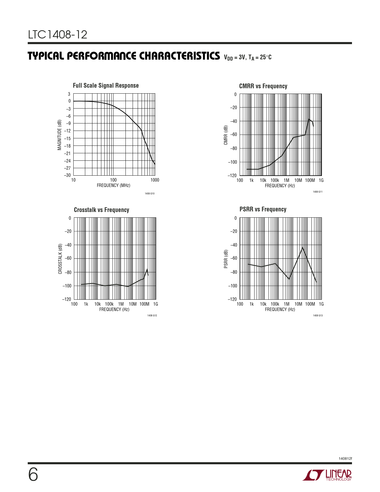

TYPICAL PERFOR A CE CHARACTERIST. ICS DD = 3V, TA = 25. Full Scale Signal Response. CMRR vs Frequency. Crosstalk vs Frequency
LTC1408-12
W U TYPICAL PERFOR A CE CHARACTERIST V ICS DD = 3V, TA = 25
C Full Scale Signal Response CMRR vs Frequency
3 0 0 –3 –20 –6 –40 –9 –12 –60 –15 CMRR (dB) –18 MAGNITUDE (dB) –80 –21 –24 –100 –27 –30 –120 10 100 1000 100 1k 10k 100k 1M 10M 100M 1G FREQUENCY (MHz) FREQUENCY (Hz) 1408 G11 1408 G10
Crosstalk vs Frequency PSRR vs Frequency
0 0 –20 –20 –40 –40 –60 –60 PSRR (dB) CROSSTALK (dB) –80 –80 –100 –100 –120 –120 100 1k 10k 100k 1M 10M 100M 1G 100 1k 10k 100k 1M 10M 100M 1G FREQUENCY (Hz) FREQUENCY (Hz) 1408 G12 1408 G13 140812f 6
