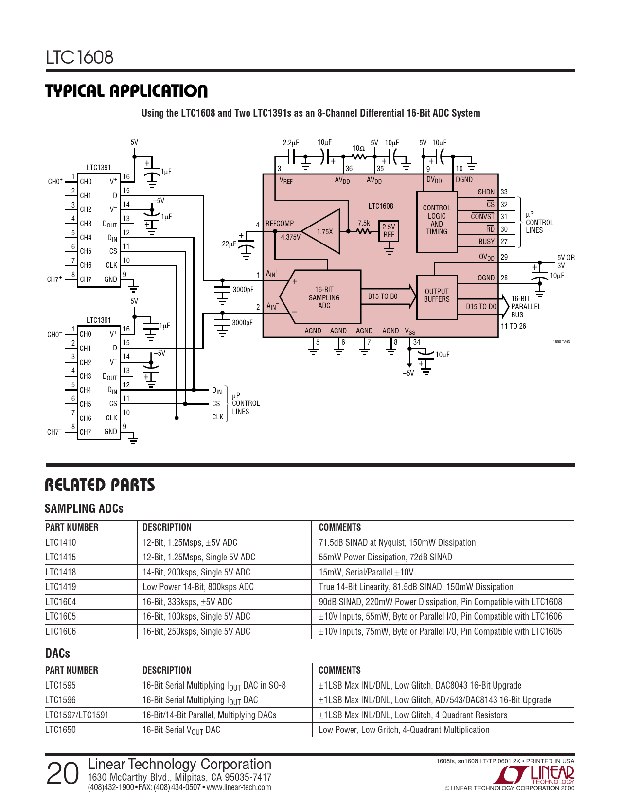

TYPICAL APPLICATIO. Using the LTC1608 and Two LTC1391s as an 8-Channel Differential 16-Bit ADC System. RELATED PARTS
TYPICAL APPLICATIO Using the LTC1608 and Two LTC1391s as an 8-Channel Differential 16-Bit ADC System RELATED PARTS
LTC1608
U TYPICAL APPLICATIO Using the LTC1608 and Two LTC1391s as an 8-Channel Differential 16-Bit ADC System
5V 2.2µF 10µF 5V 10µF 5V 10µF 10Ω + + + + LTC1391 3 36 35 9 10 1µF 1 CH0+ 16 CH0 V+ VREF AVDD AVDD DVDD DGND 2 15 SHDN 33 CH1 D –5V 3 14 CS 32 LTC1608 CH2 V– CONTROL LOGIC µP 4 13 + 1µF CONVST 31 CH3 D REFCOMP 7.5k CONTROL OUT 4 2.5V AND RD 30 5 12 1.75X LINES TIMING CH4 D + 4.375V REF IN BUSY 27 6 11 22µF CH5 CS OV 29 7 10 DD 5V OR CH6 CLK 3V + + 8 9 1 AIN 10µF CH7+ CH7 GND OGND 28 + 3000pF 16-BIT OUTPUT SAMPLING B15 TO B0 5V BUFFERS 16-BIT A – 2 IN ADC D15 TO D0 PARALLEL – BUS LTC1391 1µF 3000pF 11 TO 26 1 16 AGND AGND AGND AGND VSS CH0– CH0 V+ 1608 TA03 2 15 5 6 7 8 34 CH1 D –5V 10µF 3 14 + CH2 V– 4 13 + –5V CH3 DOUT 5 12 CH4 DIN DIN µ 6 11 P CH5 CS CS CONTROL 7 10 LINES CH6 CLK CLK 8 9 CH7– CH7 GND
