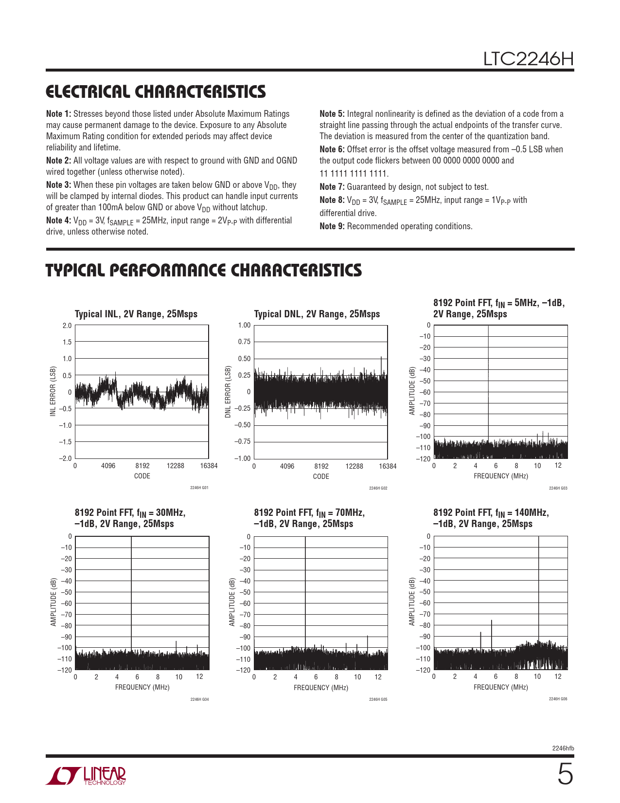

ELECTRICAL CHARACTERISTICS. Note 1:. Note 5:. Note 6:. Note 2:. Note 3:. Note 7:. Note 8:. Note 4:. Note 9:
ELECTRICAL CHARACTERISTICS Note 1: Note 5: Note 6: Note 2: Note 3: Note 7: Note 8: Note 4: Note 9:
LTC2246H
Note 5:
Integral nonlinearity is defi ned as the deviation of a code from a may cause permanent damage to the device. Exposure to any Absolute straight line passing through the actual endpoints of the transfer curve. Maximum Rating condition for extended periods may affect device The deviation is measured from the center of the quantization band. reliability and lifetime.
Note 6:
Offset error is the offset voltage measured from –0.5 LSB when
Note 2:
All voltage values are with respect to ground with GND and OGND the output code fl ickers between 00 0000 0000 0000 and wired together (unless otherwise noted). 11 1111 1111 1111.
Note 3:
When these pin voltages are taken below GND or above VDD, they
Note 7:
Guaranteed by design, not subject to test. will be clamped by internal diodes. This product can handle input currents
Note 8:
VDD = 3V, fSAMPLE = 25MHz, input range = 1VP-P with of greater than 100mA below GND or above VDD without latchup. differential drive.
Note 4:
VDD = 3V, fSAMPLE = 25MHz, input range = 2VP-P with differential
Note 9:
Recommended operating conditions. drive, unless otherwise noted.
TYPICAL PERFORMANCE CHARACTERISTICS 8192 Point FFT, fIN = 5MHz, –1dB, Typical INL, 2V Range, 25Msps Typical DNL, 2V Range, 25Msps 2V Range, 25Msps
2.0 1.00 0 –10 1.5 0.75 –20 1.0 0.50 –30 –40 0.5 0.25 –50 0 0 –60 –70 –0.5 –0.25 INL ERROR (LSB) DNL ERROR (LSB) AMPLITUDE (dB) –80 –1.0 –0.50 –90 –100 –1.5 –0.75 –110 –2.0 –1.00 –120 0 4096 8192 12288 16384 0 4096 8192 12288 16384 0 2 4 6 8 10 12 CODE CODE FREQUENCY (MHz) 2246H G01 2246H G02 2246H G03
8192 Point FFT, fIN = 30MHz, 8192 Point FFT, fIN = 70MHz, 8192 Point FFT, fIN = 140MHz, –1dB, 2V Range, 25Msps –1dB, 2V Range, 25Msps –1dB, 2V Range, 25Msps
0 0 0 –10 –10 –10 –20 –20 –20 –30 –30 –30 –40 –40 –40 –50 –50 –50 –60 –60 –60 –70 –70 –70 AMPLITUDE (dB) –80 AMPLITUDE (dB) –80 AMPLITUDE (dB) –80 –90 –90 –90 –100 –100 –100 –110 –110 –110 –120 –120 –120 0 2 4 6 8 10 12 0 2 4 6 8 10 12 0 2 4 6 8 10 12 FREQUENCY (MHz) FREQUENCY (MHz) FREQUENCY (MHz) 2246H G04 2246H G05 2246H G06 2246hfb 5
