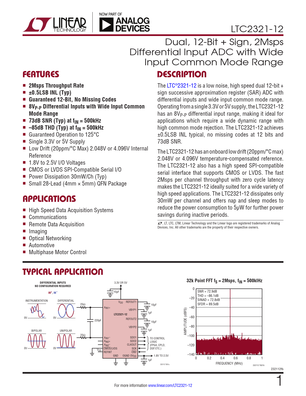

2Msps Throughput Rate
The LTC®2321-12 is a low noise, high speed dual 12-bit + n
±0.5LSB INL (Typ)
sign successive approximation register (SAR) ADC with n
Guaranteed 12-Bit, No Missing Codes
differential inputs and wide input common mode range. n
8VP-P Differential Inputs with Wide Input Common
Operating from a single 3.3V or 5V supply, the LTC2321-12
Mode Range
has an 8VP-P differential input range, making it ideal for n
73dB SNR (Typ) at fIN = 500kHz
applications which require a wide dynamic range with n
–85dB THD (Typ) at fIN = 500kHz
high common mode rejection. The LTC2321-12 achieves n Guaranteed Operation to 125°C ±0.5LSB INL typical, no missing codes at 12 bits and n Single 3.3V or 5V Supply 73dB SNR. n Low Drift (20ppm/°C Max) 2.048V or 4.096V Internal The LTC2321-12 has an onboard low drift (20ppm/°C max) Reference 2.048V or 4.096V temperature-compensated reference. n 1.8V to 2.5V I/O Voltages The LTC2321-12 also has a high speed SPI-compatible n CMOS or LVDS SPI-Compatible Serial I/O serial interface that supports CMOS or LVDS. The fast n Power Dissipation 30mW/Ch (Typ) 2Msps per channel throughput with zero cycle latency n Small 28-Lead (4mm × 5mm) QFN Package makes the LTC2321-12 ideally suited for a wide variety of high speed applications. The LTC2321-12 dissipates only

TYPICAL APPLICATION 32k Point FFT f DIFFERENTIAL INPUTS
3.3V OR 5V
S = 2Msps, fIN = 500klHz NO CONFIGURATION REQUIRED
0
IN+, IN–
10µF SNR = 72.9dB THD = –86.1dB –20 INSTRUMENTATION DIFFERENTIAL SINAD = 72.8dB V REFOUT1 25Ω DD 10µF SFDR = 89.5dB AIN1+ –40 VBYP1 1µF
LTC2321-12
0V 0V –60 220pF REFOUT2 10µF
