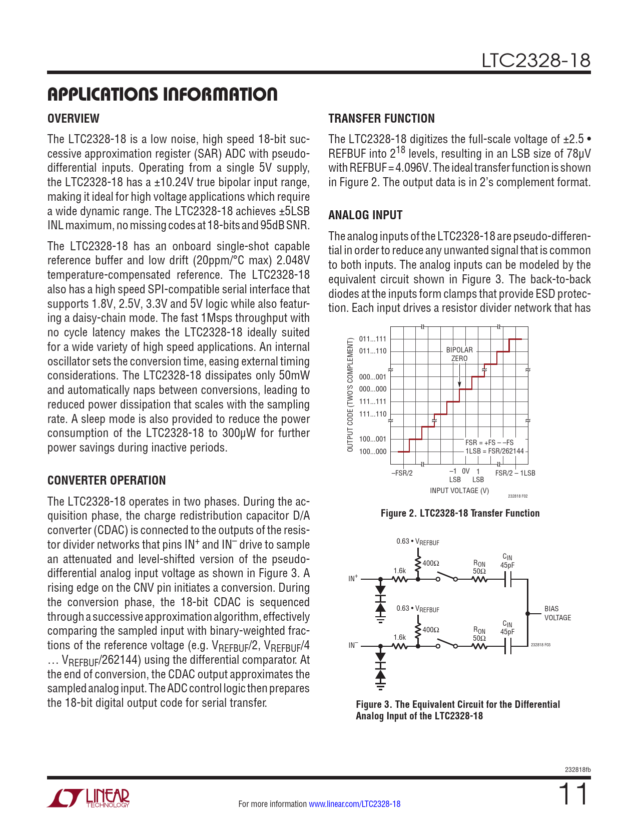

applicaTions inForMaTion. OVERVIEw. TRANSFER FUNCTION. ANALOG INPUT. CONVERTER OPERATION. Figure 2. LTC2328-18 Transfer Function
applicaTions inForMaTion OVERVIEw TRANSFER FUNCTION ANALOG INPUT CONVERTER OPERATION Figure 2 LTC2328-18 Transfer Function
LTC2328-18
The LTC2328-18 is a low noise, high speed 18-bit suc- The LTC2328-18 digitizes the full-scale voltage of ±2.5 • cessive approximation register (SAR) ADC with pseudo- REFBUF into 218 levels, resulting in an LSB size of 78µV differential inputs. Operating from a single 5V supply, with REFBUF = 4.096V. The ideal transfer function is shown the LTC2328-18 has a ±10.24V true bipolar input range, in Figure 2. The output data is in 2’s complement format. making it ideal for high voltage applications which require a wide dynamic range. The LTC2328-18 achieves ±5LSB
ANALOG INPUT
INL maximum, no missing codes at 18-bits and 95dB SNR. The analog inputs of the LTC2328-18 are pseudo-differen- The LTC2328-18 has an onboard single-shot capable tial in order to reduce any unwanted signal that is common reference buffer and low drift (20ppm/°C max) 2.048V to both inputs. The analog inputs can be modeled by the temperature-compensated reference. The LTC2328-18 equivalent circuit shown in Figure 3. The back-to-back also has a high speed SPI-compatible serial interface that diodes at the inputs form clamps that provide ESD protec- supports 1.8V, 2.5V, 3.3V and 5V logic while also featur- tion. Each input drives a resistor divider network that has ing a daisy-chain mode. The fast 1Msps throughput with no cycle latency makes the LTC2328-18 ideally suited for a wide variety of high speed applications. An internal 011...111 011...110 BIPOLAR oscillator sets the conversion time, easing external timing ZERO considerations. The LTC2328-18 dissipates only 50mW 000...001 and automatically naps between conversions, leading to 000...000 reduced power dissipation that scales with the sampling 111...111 rate. A sleep mode is also provided to reduce the power 111...110 consumption of the LTC2328-18 to 300μW for further 100...001 power savings during inactive periods. FSR = +FS – –FS OUTPUT CODE (TWO’S COMPLEMENT) 100...000 1LSB = FSR/262144 –FSR/2 –1 0V 1
CONVERTER OPERATION
FSR/2 – 1LSB LSB LSB INPUT VOLTAGE (V) The LTC2328-18 operates in two phases. During the ac- 232818 F02 quisition phase, the charge redistribution capacitor D/A
converter (CDAC) is connected to the outputs of the resis- tor divider networks that pins IN+ and IN– drive to sample 0.63 • VREFBUF an attenuated and level-shifted version of the pseudo- CIN 400Ω RON 45pF differential analog input voltage as shown in Figure 3. A 1.6k 50Ω IN+ rising edge on the CNV pin initiates a conversion. During the conversion phase, the 18-bit CDAC is sequenced 0.63 • V through a successive approximation algorithm, effectively REFBUF BIAS VOLTAGE comparing the sampled input with binary-weighted frac- C 400Ω R IN ON 45pF tions of the reference voltage (e.g. V 1.6k 50Ω REFBUF/2, VREFBUF/4 IN– 232818 F03 … VREFBUF/262144) using the differential comparator. At the end of conversion, the CDAC output approximates the sampled analog input. The ADC control logic then prepares the 18-bit digital output code for serial transfer.
Figure 3. The Equivalent Circuit for the Differential Analog Input of the LTC2328-18
